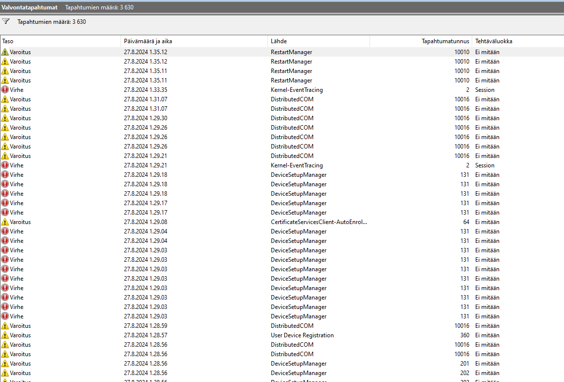

    2024-09-05T08:56:36+00:00
    My unyielding torrent of errors began immediately following my NVIDIA driver update. I didn't really connect the two because it did it without my approval. I swear to god I make these changes, and Microsoft come crawling out of the woodwork & messes with my settings again. So my monitor sleep settings were all the sudden set to the "Look over there, now look back - I'm turned off!" selection and I checked the update list and saw the driver update (though it still shows I have updates turned off, so maybe it was NVIDIA-driven).
    Anyhoo, I looked at the Event log errors and yes, they all occur just after that driver update...

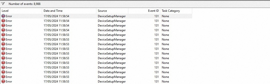

    2024-05-17T12:11:17+00:00
    Same here.
    This is ridiculous now. It's happening every second.
    I now have almost 9,000 of these errors and Microsoft do not care to fix this ongoing issue.
