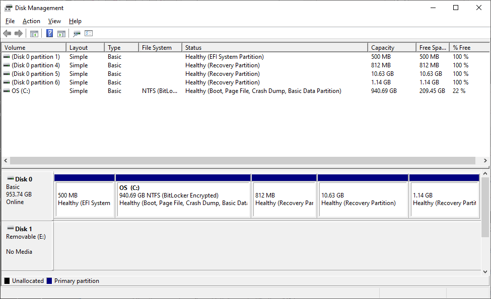

    Also, this machine has 3 recovery partitions!
    Confirmed in DISKPART
    That 12.6GB of recovery partition, and partitions 5 and 6 seem to provide way more space than required, yet KB5034441 continues to fail. This partition layout is as the machine came supplied from Dell.
    Do I need delete partitions 4, 5 and 6, enlarge 3 ad add back a recovery partition of 1GB at the end of the disk? Any ideas on why 3??

    I noticed the same thing. It is a mystery what the MS folks are doing with this Partition since it is essentially empty on Win 10 MBR, Win 10 GPT and Win 11 GPT PCs.
    The partition is empty only after completing the MBR version of KB5028997. The partition is empty by default after running the disable command as Windows RE gets preserved on drive C. Every time the disable and enable commands are run, the recovery image changes its location. It fails to return to a partition that is not actually a recovery one and gets deployed on drive C instead.
    The strange thing is my older PC completed this troubled update without a Recovery Partition identified?
    With no recovery partition dedicated, the recovery partition is drive C which always has the necessary space available.
