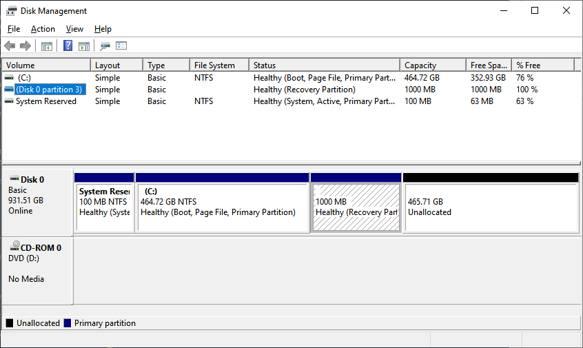

    Answering my only question ... partially ...
    I had a look in diskpart and indeed the created recovery partition was type 07, no longer 27. Using set id=27 the partition is now listed as a recovery partition:
    v previously
    I see it is now entirely empty and so while I might have a recovery partition, there seems to be nothing there to recover from and this is an elderly machine. God knows where any media would be. Maybe the next thing to look at is how to create something in the recovery partition!

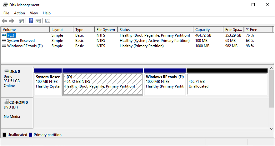

    2024-03-19T11:02:14+00:00
    This does not actually create a recovery partition. The second line reverts the id set in line one.
    You may have noticed the partition is no longer tagged recovery. Your Windows RE has been enabled on drive C due to the former recovery partition not recognized. You may run
    set id=27
    in diskpart right now and disable/enable the recovery environment one more time. This time the recovery partition will be recognized.
    I'm not sure I understand.
    The first line creates the partition and sets the type of the logical drive created as 0x27, meaning a Win RE partition. The second line then formats that logical drive and gives it a label, but that's not going to alter the drive type. The format is in effect a higher level command carried out within the bounds set by the lower level partitioning of the disk.
    I don't understand why you say the second line "reverts the id set in the first". The format can only operate on the partitioned area of the disk, while the creating of the partition and setting the partition id are part of the entire physical disk MBR
