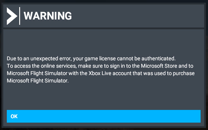

    I have had this error or its equivalent from day 1 of using MSFS in August. I have tried opening lots of suggested firewall ports etc. but to no avail. The error message I now get on startup is this. I am signed into the Microsoft Store and Xbox Live as required but I get no multiplayer server connection or live traffic.

    Same Issue here, Very frustrated. Can not do anything. Anyone had feedback from Microsoft or Xbox Image

    Hello saverio,
    well, looks like that some update caused that problem. As it run before as it should, i think it is NOT a server/router prolem, but might be an update problem. I have faced this too.
    here is what i did, and i do suggest it to you, but it is your decision.
    The MSFS2020 needed to be reinstalled, and NO CHANGING to the suggested path for installation. That helped me.
    I had purchased the BOX Premium Deluxe version, but needed to RE-INSTALL it again via the Microsoft store. Downladed the base version, installed it, made the Update to Premium version, and had to Downlaod this Monster Patch ( 70GB ) again. I did NOT change the suggested path when re-installing the FS again. ( no trouble with the ONE-TIME -CODE )... i just ignored it.
    I know, that it is a pain in the a**, but it helped me.
    Believe me, i had tried a lot within my router ( FritzBox ) regarding settings Ports, passwords, adding some more ports...
    Nothing helped.
    only the new installing of the 2020.
    I know , sounds like sad news, i keep my fingers cross that it will then work for you.
    Good Luck

    also a good idea is to CLOSE the XBOX-Live app, and RESTART it again, then run the MSFS2020 and hopefully it works.
