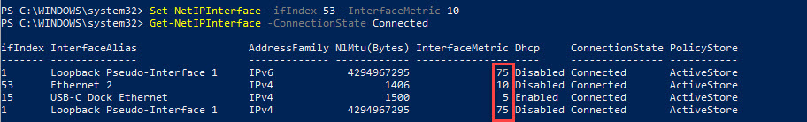

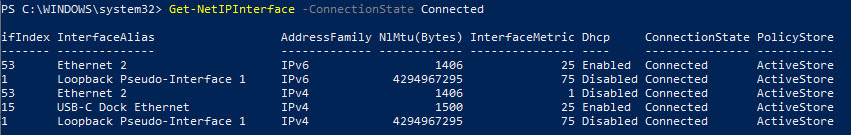

Windows 10 doesn't allow you to change the adapter binding priority via the GUI, however you can adjust the adapter binding via powershell:
Alternatively, you can set all of the interfaces to use an Automatic InterfaceMetric which allows Windows to prioritize them based on the number of connections you're concurrently using. To do this type:
Set-NetIPInterface -ifIndex ## -AutomaticMetric Enabled **Note** - I don't have AutomaticMetric enabled for any of my interfaces.
A restart of your computer may be needed. I'm not doubling down on this, but all of these steps in combination have made a significant improvement in the way Windows 10 registers (or lack there of) the internet connection.
