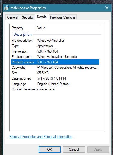

    (1) It looks to me you've got a good MSIExec.exe. Yours is for 1809, but it's got a date 2 months newer even than mine which is 1909. Something is nutty with Autoruns, looks like, regarding Timestamps. One of them on a file I've got looks pretty old too (1982).
    (2) Regarding Fontbase, you did enough to remove that useless entry. It went to a file that no longer existed. If the image path had led to an empty folder (or one that looked pretty much it belonged only to Fontbase), it would have been tidy to delete that folder. Actually, right-clicking Fontbase in Autoruns & selecting "Jump to image" likely would have said whether the folder still existed by opening it or not. But doing a search in File Explorer probably was risky. I'm glad it found nothing that could be deleted.
    (3) Right-click "C:\PROGRA~3\INTERE~1\INTERE~2.DLL" in Autoruns, & select "Jump to image". What happens? If it says the folder doesn't exist, just delete the entry. Otherwise, let's see what's in the folder.
    (4) That's a pity that SFC still will not run in Windows. But /Checkhealth is the least informative option for DISM. Do this one...
    DISM  /Online  /Cleanup-Image  /ScanHealth
    If it says "repairable", then do a "/RestoreHealth" which actually makes the repairs. And try SFC afterward. I hope it will run.

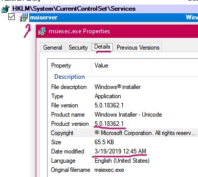

    (1) Regarding that Autoruns report...
    (a) Fontbase  apparently didn't uninstall elegantly. It left behind its Startup entry & even left it checked. You should right-click it, & select "Delete" which removes the entry from the Registry (& from Autoruns). I might also follow that image path to its ultimate destination folder (the ellipsis indicate there's more - point to it or expand the column). If you can determine that ultimate folder belonged entirely to Fontbase, then delete it too for neatness sake.
    (b) My entry named "OneDrive" wasn't flagged by any antivirus, but I don't suppose yours is infected. Mine is in a different location than yours, but I'm 1909. Also, it might be the SysWOW64 folder (where yours is) gets involved in legit circumstances you have invoked (but I didn't)...
    (c)My "Onedrive Standalone Updater" is named a bit differently & is in a different location than yours. Maybe that's an 1809/1909 difference -- I don't know. But when you see "the operation timed out" in the Virus Total column, right-click it, & select "Resubmit to Virus Total". It may take a minute/so, but should return with a result.
    (d) "Microsoft\Windows\re..." & "C:\Progra~3\Inter..." are like Fontbase (above). Right-click those two, & select "Copy". Then paste them here so I may see the full entry names & the full paths. Can you explain what they are/were? Does the ultimate folder in the path have anything in it &/or does it look entirely like something you've uninstalled? Treat them like I said for Fontbase, if they meet that criteria.
    (e) My MSIServer entry got no positive, but yours looks OK on that. However, yours has a date of 10/18/1973. It is ancient compared to mine of 2/14/2020...
    That one is the Windows Installer service -- could be why Windows Update is bad for you. I can't believe SFC didn't repair that one. I know you did the offline SFC. Are you able to do one in Windows now? If so -- check the date on "C:\Windows\System32\MSIExec.exe" afterwards. I can't believe 1809 should have one as old as yours.
    Edit: Now I'm not sure what that Timestamp is -- it doesn't say in the Help pages. Right-click MSIServer in Autoruns, & select Properties. What does yours show at the Details tab...?...
    Still, try a DISM & SFC to see whether it fixes anything. Your Timestamp is suspicious.
