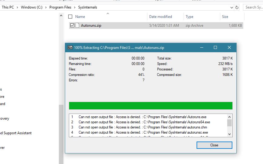

    (1) I like keeping Autoruns entirely in my Downloads folder except for the shortcut on the Desktop. If ever I do another clean install, I'll just have to restore those folders to be back in business with Autoruns (whereas it would be deleted from Program Files). The Downloads folder normally is for raw downloads of programs & drivers. So, after a clean install, it can be recovered from backups & the stuff clicked to reinstall.
    But now I've tried to extract Autoruns into "C:\Program Files\SysInternals" & got a different error than yours (I'm 1909, you know). It said it couldn't create the Autoruns folder. But, after I created it myself, the extract went well, & all worked as expected. I'm not sure that would work for you, your error messages look different.
    But I do think you probably can move what you've got on the Desktop -- is it a SysInternals folder? -- into Programs Files. Then recreate the shortcut on the Desktop. Or move SysInternals to your Downloads folder. It's excellent you persisted & got it working -- but I think your Desktop is cluttered!

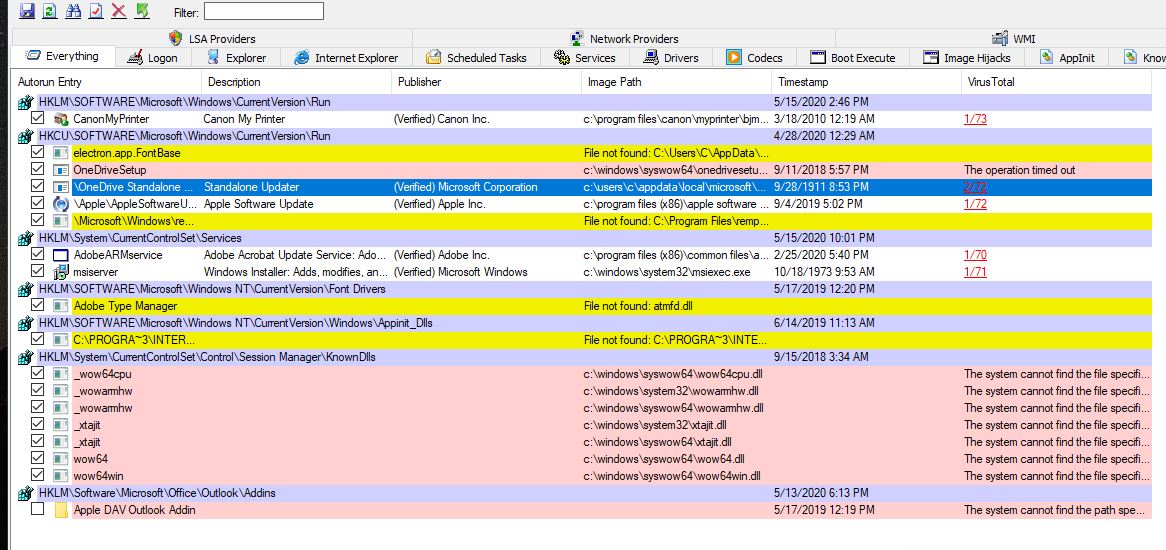

    (2) "There is a LOT in there what would you like to see?"
    Yep, there appear to be a trillion startups more than is shown in Task Manager's Startup tab. Careful you don't disable any accidentally. You'd have been able to spot where PowerDVD14Agent.exe was coming from (before you uninstalled it) by typing any part of that (say "DVD") into a Find box -- in the Entry tab (or Ctrl+F). Then, Find Next (or F3) will find any others. But, mainly, you want to look for anything suspicious, then investigate it. Here's one thing to do...

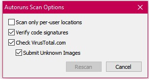

    (a) Set "Options tab, Scan options" to verify signatures & to check VirusTotal…
    You may also set Options to "Hide VirusTotal Clean Entries"...

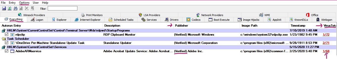

    (b) You will see the Publisher column now shows whether its signature is good, & there is a new VirusTotal column. Click the "Everything" tab to ensure all locations are shown. You may adjust the columns by dragging them in the header. If only one/two antivirus scanners say it's a virus, that's likely a false alarm. "2/71" means 69 of them didn't detect a virus. If you click that figure (2/71), you are taken to the VirusTotal site & can see which said what...

    1. I tied moving the autorun  and got this
    but I did unzip it again on the desktop and found those files. Looked again and found MS had rearranged my desktop icons. I read left to right in rows and it reads everything in up and down in columns then I can't find anything. Tried the autorun from there and same thing happened.
    Deleted shortcut and clicked again and bingo it worked! Not sure why but a gift horse- not asking questions.  There is a LOT in there what would you like to see?
