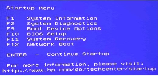

    (c) On your HP, the ESC key gets to a Startup Menu, as in...
    https://support.hp.com/us-en/document/c00007682?jumpid=hpr_r1002_usen_link2
    HP Consumer Desktop PCs - Updating the BIOS (Basic Input Output System)
    It says, "Turn on the original computer with the issue, and then immediately press the Esc key repeatedly until the Startup Menu opens." Here is the menu...
    (d) Then press F9 to see whether the Installation USB drive will show up.
