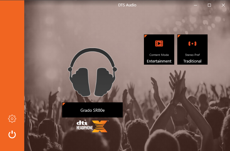

I'm using Asus tuf fx505dt
recently , preinstalled dts headphone x started showing "Please enable the PC speaker to use DTS audio" or "Please connect a headphone to use DTS audio" when I connect my headphones?
any solutions?

My laptop is FX505dt. I installed the third audio driver from the URL below(UAD - ASUS PRIME-TUF DTS) and IT WORKS.
Latest Realtek HD Audio Driver Version
https://www.tenforums.com/sound-audio/135259-latest-realtek-hd-audio-driver-version-2-a-153.html#post1841394
But I think there is still issue. I can't find any difference with surround sound and 3D fix on or off.
Procedure to install this driver:-
Option 1:
  1. Download and unzip the audio driver
  2. Disable the network
  3. Right click on the start icon
  4. Go to device manager-> Sound, video and game controller
  5. Uninstall "Realtek(R) Audio" (Please tick delete the driver software for this device.)
  6. Run the setup.exe in the audio driver folder
  7. Restart your laptop twice!!!!
  8. Go to the DTS Headphone:X v1 app and done.
Option 2:
  5. Right click on the "Realtek(R) Audio" and press "Update Driver"
  6. Press "Browser my computer for the driver software
  7. Click "Browse" to select the folder of audio driver
  8. Press next
  9. Check the driver installed (Right click on the "Realtek(R) Audio"->properties->"Driver" tab)
10.  If the version is 6.0.8895.1, restart your computer. Done
