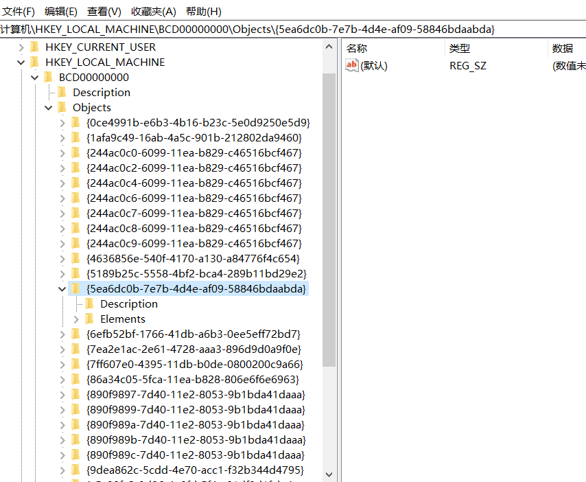

Try using bcdedit to remove the entry then check the registry to see if it is gone..  Copy and pasting GUID numbers makes it very easy to make sure the ID is correct..
bcdedit /delete {5ea6dc0b-7e7b-4d4e-af09-58846bdaabda}

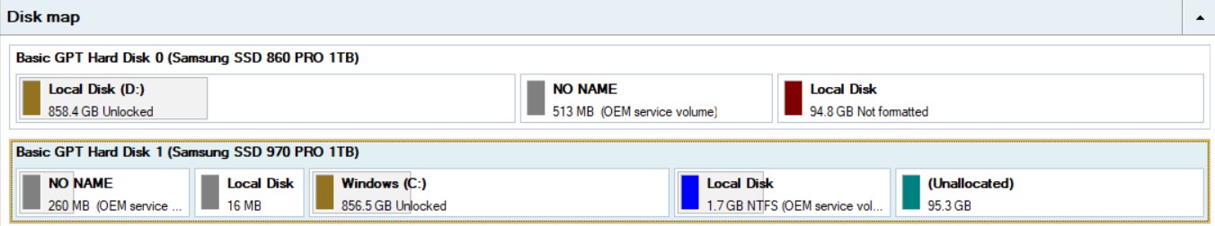

    The same Problem here, update from 1909 to 2004 (insider slow ring)
    All possibles tried, without success. (deleting softwaredistr, catroot folders, clean boot, etc.)
    Drive map: (windows is installed on 970 pro)

    this is the outpost of bcdedit -enum all -v
    and how should I do modifying or removing with that part? Delete it from regedit?
