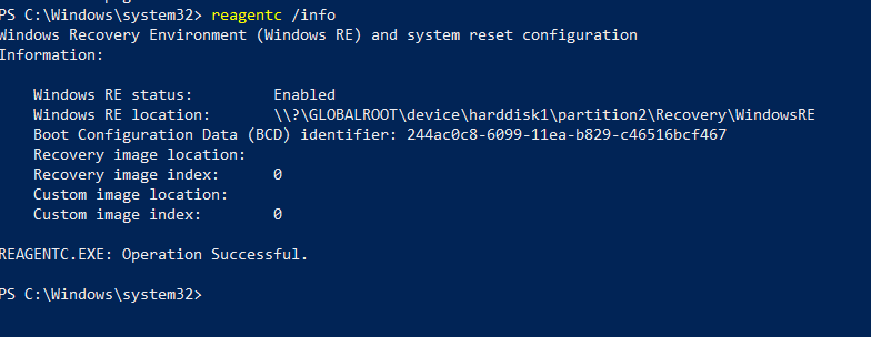

    WinRE have been enabled already.

    The last idea I have to try and I don't expect it to work is to check your Recovery Tools options.  I believe repeated upgrade attempts will disable the tools but we might try to set them up again...
    Open an admin command prompt and type the commands below.
    reagentc /info
    If it comes back and shows as disabled, type the commands below.
    reagentc /disable
    reagentc /enable
    If that won't enable it, we can try to reset the recovery tools image path..
    reagentc /setreimage /path c:\Recovery\WindowsRE /target C:\Windows
