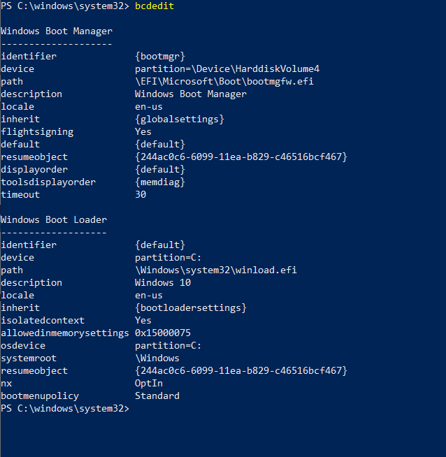

    I see two things that look a little strange.
    First, you have Flightsigning Yes which means you are in the Insiders program?
    Secondly, your default OS loader is identified as "default" which would mean you were not booted into Windows when you ran the command?
    Beyond that, you have two drives and the EFI System partition is on the second drive?
    I suppose I should ask about your locale setting.  It may be correct using en-us but I have no experience with language situations.
    Otherwise, it looks OK..
    2020-03-07T19:05:07+00:00
    hi Saltgrass ,this is listing from bcdedit.

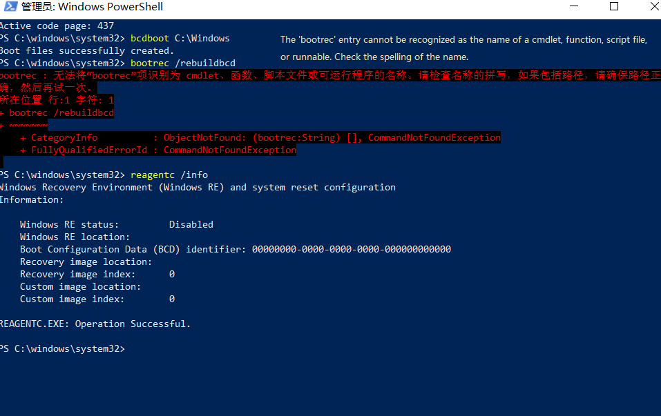

    2020-03-07T19:00:44+00:00
    Not dual booting.
    I ran reagentc /enable, it showed that The Windows RE image was not found.
    I try to Unzip  winre.wim to C:\Recovery\WindowsRE from a Windows  .iso file, then I ran reagentc /enable, it works then I ran reagentc /info ,its status was still disabled.
    And bootrec /rebuildbcd returned error.
