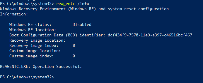

  2. SD - IA 180.3K Reputation points Independent Advisor
    2020-03-07T15:36:16+00:00
    I see the Recovery environment is disabled, which is likely why the update is failing.
    Can you enable it from the following command?
    reagentc /enable
    Also, are you dual booting?
    Here is a similar case to you, which was eventually resolved thanks to Saltgrass.
    https://answers.microsoft.com/en-us/windows/for...

    Hi Sumit.
    This is outpot:

  4. SD - IA 180.3K Reputation points Independent Advisor
    2020-03-07T12:59:03+00:00
    Thank you. It appears that Windows RE has an issue.
    2020-03-07 03:21:27, Error                 IBSLIB BCD: Failed to get registry value. Status: c0000024[gle=0x00000002]
    2020-03-07 03:21:27, Error                 IBSLIB BCD: BcdCopyObjectEx: Failed to enumerate source elements. Target: {5ea6dc0b-7e7b-4d4e-af09-58846bdaabda} Flags: 0x4 Status: c0000024[gle=0x00000002]
    2020-03-07 03:21:27, Error                 IBSLIB BCD: Failed to clone store. Status: c0000024[gle=0x00000002]
    In the CMD Window, when you type in reagentc /info what is the output?
