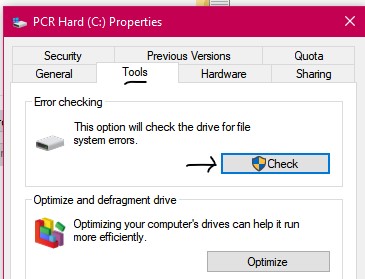

    That was smart to do a /Scan first. Sounds like it's saying big trouble can result doing a real one. I've seen a thread wherein ChkDsk really chewed up a drive. It could be wise to make a Windows system image backup before doing a real ChkDsk.
    Then maybe do this one first: "Right-click C: in File Explorer, Properties, Tools tab, Check"...
    It's much, much quicker. It should offer to reboot & do the other one, if it finds it necessary. Otherwise, go ahead & do the other afterward anyway -- first with "/Scan" (which is also quick), then without it, if it reports errors.

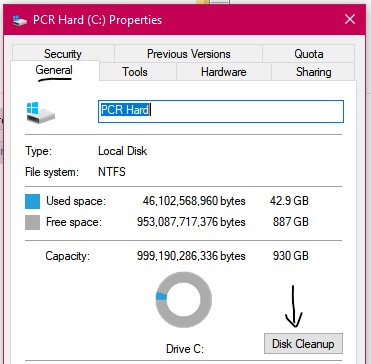

    Maybe, first, lessen the load with a Disk Cleanup at the General tab, but don't inadvertently delete your Downloads folder...
