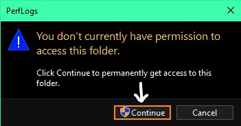

         It may ask for permission, as in...
    Just click "Continue". Do the same for the following...

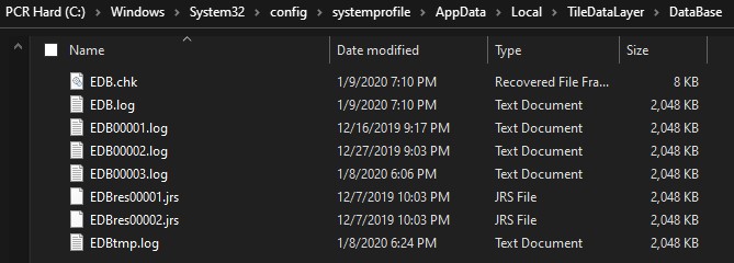

    You end up with a "C:\Windows\System32\config\systemprofile\AppData\Local\TileDataLayer\DataBase" folder...
    That's it. That will be the death knell to Event ID 455. However, the folder will soon automatically fill (maybe after a reboot) with a bundle of logs no one will ever care to look at.
