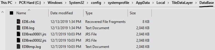

    2019-12-13T09:58:14+00:00
    The problem randomly occurs, the software has worked all week then suddenly gives this error so I don't think that's the problem.

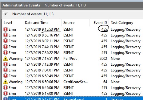

    2019-12-08T03:10:45+00:00
    Thanks, Andre, for the solution to the main issue. Looks like I've seen my last Event ID 455. I clicked refresh on the following screen at 9:52, & a new one hasn't shown up.
    However, I didn't have to do a repair-install to make the folders. I just had to click OK on the denial messages (starting with Config, I think) until I got to where I could make them.
    Odd Windows doesn't care there is no EDB.log in there. But I'm just glad to be rid of those pesky 455's!
    Edit 12/13/2019: Oops - here it is now...
