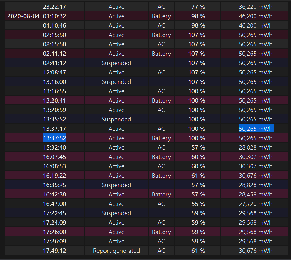

    so the problem is still not solved, today when I was playing the game it ran for 30 mins approx, but now I think it's something related to power... anyway I will perform the recalibration check but in the meantime can you please go through the battery report and let me know if you need anything else from my side.
  2. Greg Carmack 24,780 Reputation points Volunteer Moderator
    2020-08-03T20:51:35+00:00
    You removed the battery and are using the charger and it works correctly?
    Check the manufacturer's Support web page for your full model number to  see if there is a battery issue or recall for it.   Remember you have a full one year warranty for PC and parts replacement or repair so I'd use it if still available.
    Run the battery re-calibration here:  https://www.howtogeek.com/172271/how-to-calibrate-your-laptops-battery-for-accurate-battery-life-estimates/
    Then generate a battery report and post it back here:  https://www.groovypost.com/howto/generate-battery-report-windows-10/
    Right click Start to open Device Manager, under Battery choose the battery device, then Driver tab, then if available Roll Back the driver.  If not available, choose Uninstall Driver, restart PC to reinstall.
     If this was caused by Windows Updates then you can check which were installed at Settings>Update & Security>Windows Update under Installed Updates, then uninstall them from the link there, and hide with the Hide Updates tool downloaded from here:  http://download.microsoft.com/download/f/2/2/f22d5fdb-59cd-4275-8c95-1be17bf70b21/wushowhide.diagcab
    You can also use System Restore to get before the problem began, then check for Updates with the Hide Update tool and hide them:  http://home.bt.com/tech-gadgets/computing/how-to-fix-windows-10-problems-with-system-restore-11364008291943
    If this was caused by a Version Update then for 10 days you can roll it back in Settings>Update & Security>Recovery and then hide it until it matures using the Hide Updates Tool which is explained more here:
    https://www.howtogeek.com/223864/how-to-uninstall-and-block-updates-and-drivers-on-windows-10/.
    If nothing else helps then you might need to replace the battery. However I will tell you that most OEM after-market batteries and chargers have problems so I would only buy the official manufacturer's battery from the PC maker to be sure.
