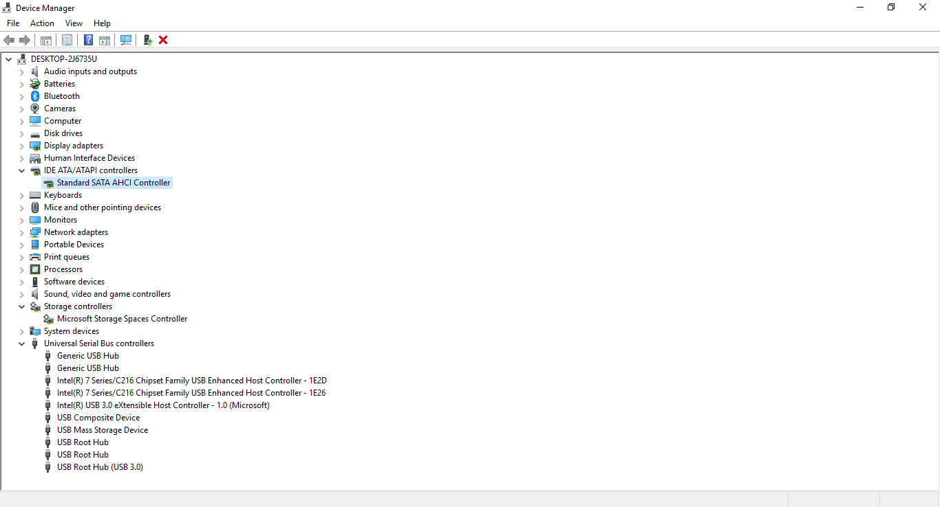

    Can you do the following:
    In the Device Manager right-click "standard ahci sata controller " > Update driver > Browse my computer for driver software > Let me pick from a list of device drivers on my computer
    What is listed under Model (with "Show compatible hardware" "checked") ?
    2018-10-21T17:06:15+00:00
    there is no Intel(R) 7 Series Chipset Family SATA AHCI Controller
    there is standard ahci sata controller and the hardware id is
    PCI\VEN_8086&DEV_1E03&SUBSYS_FB311179&REV_04
    PCI\VEN_8086&DEV_1E03&CC_010601
    or you mean something else?
