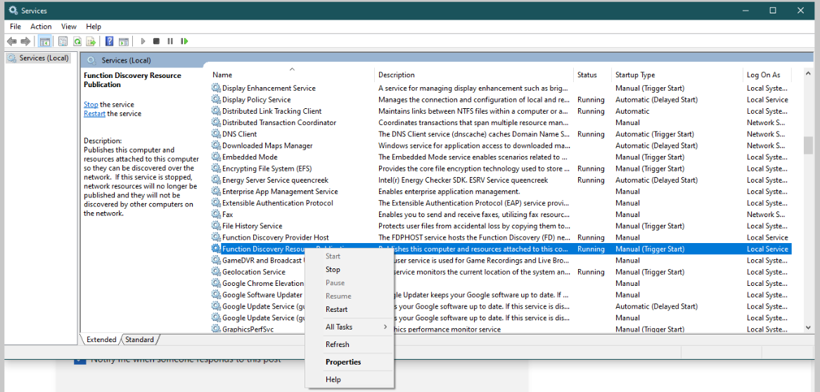

    I had the same problem and here is how I solved it.
    The problem with FDResPub is the trigger. What you need to do is to remove the trigger and set the startup as Automatic. You can do that using the sc.exe command. I prefer using a small app named Service Trigger Editor. Just type it up in Google and you will easily find where to download it from. When you start the app you just find the FDResPub service and remove the trigger. Then open your services, find FDResPub and set the startup type to automatic. Reboot the computer. You can remove the task in Task Scheduler, you won't need it anymore.
    I am not sure why Microsoft added this trigger to FDResPub. The trigger is supposed to start the FDResPub service when your network is changed to Private. The problem is if your network is already Private the trigger is not activated and FDResPub is not started.
    I hope this will help you.

    @BeveHoward,
    Restarting FDResPub is only a remedy for Win 10 in the case that your own PC is not visible on the network.
    To see this problem you can turn off all the other machines and just leave one on, if that only machine does not show on the network after a restart then you have this specific bug, otherwise you are facing a completely different issue that has nothing to do with this thread or the workarounds mentioned here.
    Problems with a mix of Windows 10 and other older versions 8.1 or 7 may be in other discussions.
    This thread is just addressing one particular problem of Windows 10 that seems to affect only some types of Ethernet adapters.
    I was just mentioning that to test if FDResPub restart has any effect, you can just restart it manually as shown here in this snapshot,  no need to set up a task just to see if has any effect.
    Another simple way to test this is by issuing the 2 commands below from an elevated command prompt.
    C:\WINDOWS\system32>net stop fdrespub
    The Function Discovery Resource Publication service is stopping.
    The Function Discovery Resource Publication service was stopped successfully.
    C:\WINDOWS\system32>net start fdrespub
    The Function Discovery Resource Publication service is starting.
    The Function Discovery Resource Publication service was started successfully.

    What is the startup type of the FDResPub service on your problematic machine?
    @BenoitHuard,
    The startup for FDResPub is just the default Manual with trigger.
    It fails the same if set for Automatic or Automatic Delay Start.
    The failure is only with specific Ethernet adapters, never failed with Wi-Fi.
    1. Restarting FDResPub always fixes the problem, that is why I restart it through a set up Task in Task Scheduler.
    2. As a second remedy, if I enable Remote Desktop in Windows 10 Pro, it never fails either.
    So I have 2 possible remedies for the bug. I use # 1 if I don't want to enable Remote Desktop.
