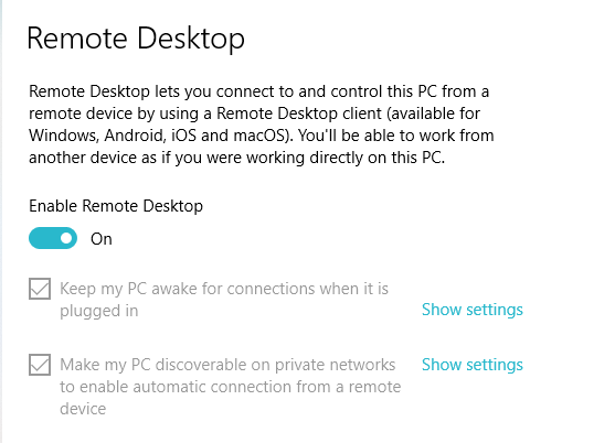

    Another workaround that fixed the problem described in this thread for Win 10 is just enabling Remote Desktop, in that case there is no need of restarting FDResPub with Task Scheduler.

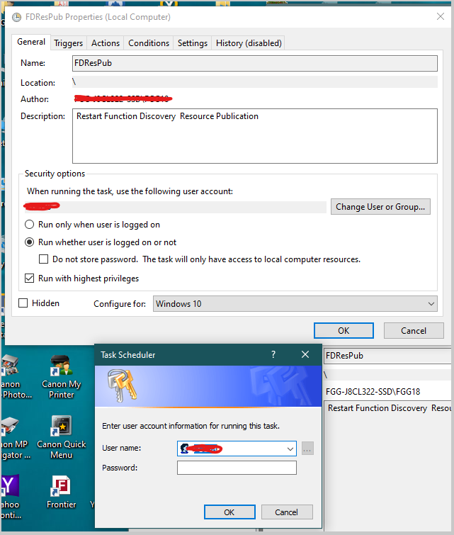

    >> FDResPub <<
    The problem seemed to have cured itself, but it's back.
    I turned on all of the services listed in the response on the first page of this (very long) thread, but that didn't work.
    So, I set up a task scheduler event for FDResPub as suggested in the above post, but, it does not work, including restarting the computer.
    fwiw, when I was presented with a login credential screen with my current login as the user, but, when I filled in the password, I received the message that "The specified Account name is not valid"

    See my first entry on page 18 to setup the FDResPub Restart in Task scheduler.

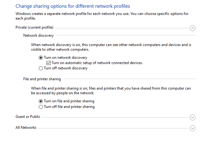

    All the other settings should be just the windows 10 defaults for File sharing on Private network, no need for any special settings.
