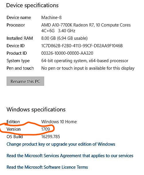

    (1) The computer's current version is 1709, & it has the latest OS Build 16299.785 (for that version). And its Architecture is 64-bit/x64. It is Home edition.

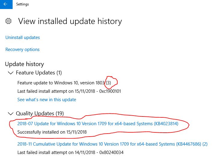

    (2) KB4023814 (that you circled in your picture) is the MSFT Update Assistant. It downloads & installs (or just runs) when MSFT has determined the computer's Windows version is too old. That determination is made when the version is the 2nd version back. 1709 is two back from 1809 (which has been rereleased). But apparently it wants to install 1803. You should skip that & hope 1809 installs better. By doing it yourself from a download it hopefully goes better.
    (3) Look for KB4023814 or Update Assistant at "START, Settings, Apps" & uninstall it, if found. Either scroll down the list & click it, or click "Programs & Features" at the right & click it in that list. Then click the Uninstall button.

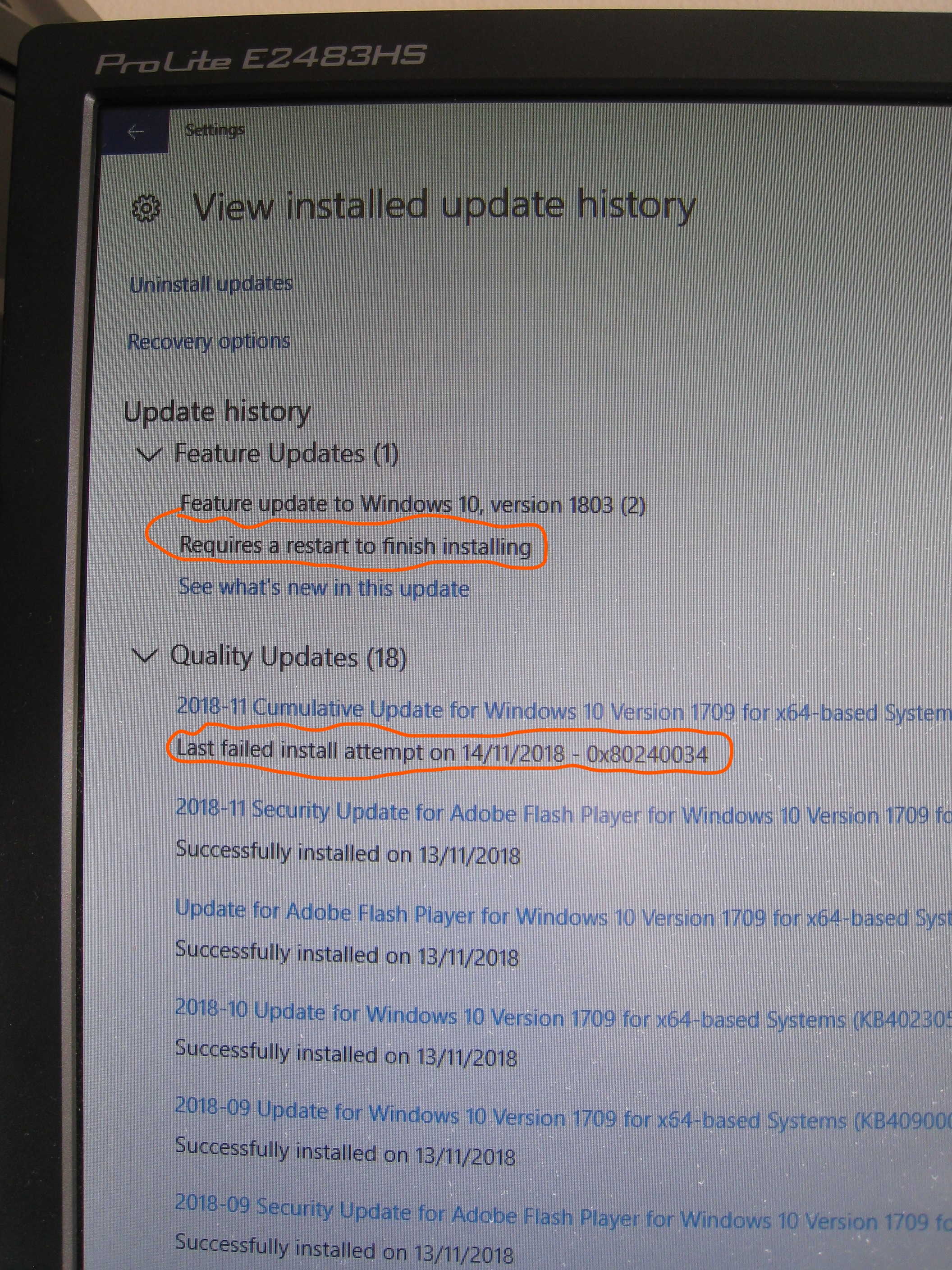

    It is a friend’s Asus A88XM-PLUS motherboard inside a Palicomp AMD Averi Evolution; latest BIOS and standard peripherals, no more, no less, supplied at sale with Windows 8/8.1. Worked flawlessly until summer 2018 then crashed twice in two months with no boot. Fixed by corner shop engineers twice for about $250. Crashed again last month and I was asked to fix it. Immediately found problems indicating BIOS boot security settings so reset and updated BIOS and set boot security to zero or low and was then able to try repairing, but impossible from standard options available. Then tried to reinstall from USB, Internal DVD, external DVD, etc but always received formatting errors. Suspected hardware error, probably memory, etc. Without going into detail I found a workaround and obtained a viable installation, I think dated 17.03. Then I performed a thorough check of hard disk (chkdsk, DISM, SFC, etc) and all components, and fixed driver problems for integrated graphics, hard disk controller and monitor driver, so all seemed well. It then self-upgraded to 17.09, which is where the upgrade problems then started, but I emphasise that it does now appear to be stable, but stuck at 17.09 although it claims that it is at 18.03 ‘after a reboot’ which, of course, never actually happens, and probably with no chance of updating any further. Graphics attached (specific error message 0xc1900101 is in the second graphic).
    Can you also suggest the best way of carrying out a memory check? Current configuration is one 8GB stick.
