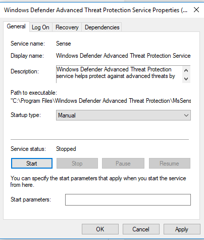

    2018-08-21T19:36:04+00:00
    Hi Halo,
    It turns out that Advanced Threat Protection (ATP) is a feature, only available on
    W10 Pro or Enterprise. It is one that you can opt in for if you wish. Therefore, if
    you have not opted for this protection, it is logical that its service might not be
    running. However, without it, you only have three WD services listed. Which one
    are you missing? And, can you examine the "policies", activated on your PC, to
    determine whether ATP has been authorized or not.

    2018-08-21T03:39:52+00:00
    Halo
    "Windows Defender Advanced Threat Protection Service" !!
    Maybe you have something that we can pursue.  Are you on W10 Pro? I am on Home,
    and I don't have that service. But lets find out which one that it is. I have the following:
    Security Center Service  Running and set for Automatic (delayed)
    WD Antivirus Network Inspection Service.  Running, but set for manual start.
    WD Antivirus Service.  Running and set for Automatic
    WD Firewall Service.   Running and set for Automatic
    WD Security Center Service.  Running and set for Automatic
    Do you have three of the four WDs above? If so, which one of these is missing.?
    If you are on Pro, this may be normal. If not, something is wrong for sure!
    In any case, They surely, should all be running.
    You say "This all started with a virus". Tell me how the services are different, and
    then, what you did to get rid of the virus. Do you know the name of the virus?
    Did you use more than one anti-malware program in the process?
    And have you tried the BitDefender Rescue disk, that I previously described?
    It may be more effective, since it runs offline, without possible interference.
    Check back. In the mean time I will investigate the (service) that you have above.
    Regards,  Glen
    2018-08-21T00:00:34+00:00
    Thanks. I got 3/4 services running. The last one here. When I click OK it says Access Denied. When I click start it says service cannot be started. It all started with a virus.
