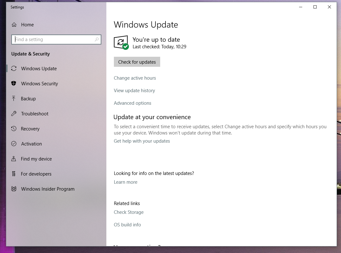

    2018-05-10T10:36:22+00:00
    FINALLY!!!!.....
    My machine is now completely up to date and rebooting as normal.
    Do this....
    Get in to Safe mode, (I press the reset button on front of machine during windows logo screen 2 or 3 times to get to startup repair) then troubleshoot, advanced, startup options. Restart and choose option 5 for Safemode.
    In safe mode i uninstalled Advanced systemcare and ran a few security scans. Then reboot. The pc should boot normally. Yes you get the black screen with spinnig circle but only for a short period.
    Once booted, go here... https://www.catalog.update.microsoft.com/Search.aspx?q=KB4103721 and manually download the update to your desktop. Install it. Reboot and you're done.
    Now check in Windows Update Centre. You should have like i do. See pic....
