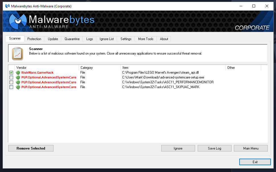

    After uninstalling ASC ive temporarily disabled automatic updates and i have been doing a few scans (even though i do scan often) and Malwarebytes found a few items to do with ASC. See Pic........
