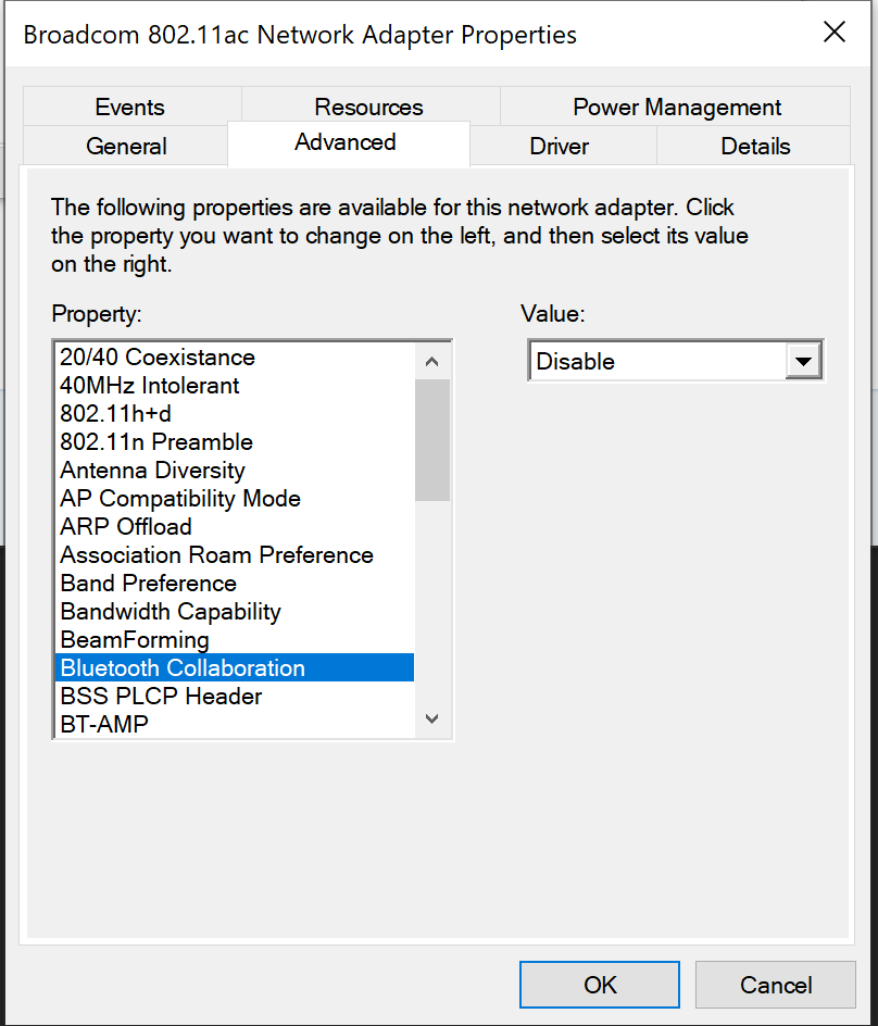

2019-06-26T19:35:44+00:00 Yes, there is some sort of issue with the Broadcom Network Adapter drivers. I disabled it and it solved the problem, but I was left without WIFI. So I opened up the Device Manager, went into Broadcom Network Adapter Properties, choose Advanced, and then turned the "Bluetooth Collaboration" Value to "Disable". Works now without the stutter and still have WIFI.
