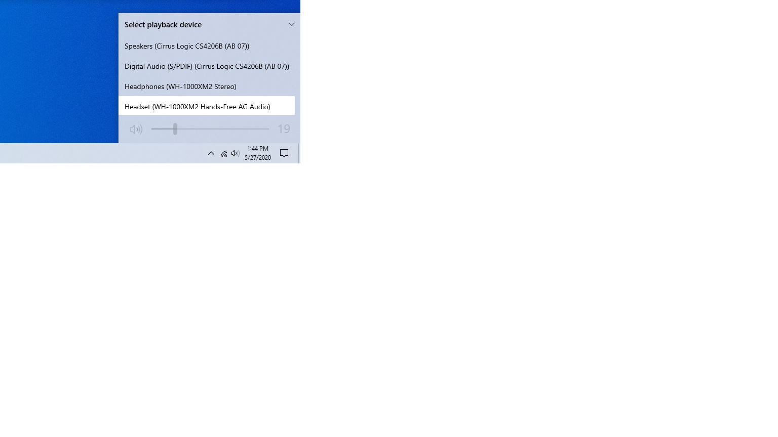

    2020-05-27T20:56:57+00:00
    I have the same issue with the Sony WH-1000XM2 headset . I resolved the issue by changing the selected playback device in the sound settings. For some reason there were two devices listed:
    Headphones (WH-1000XM2 Stereo)
    Headset (WH-1000XM2 Hands-Free AG Audio)
    I selected the second one (Headset) and it resolved the skipping problem.
