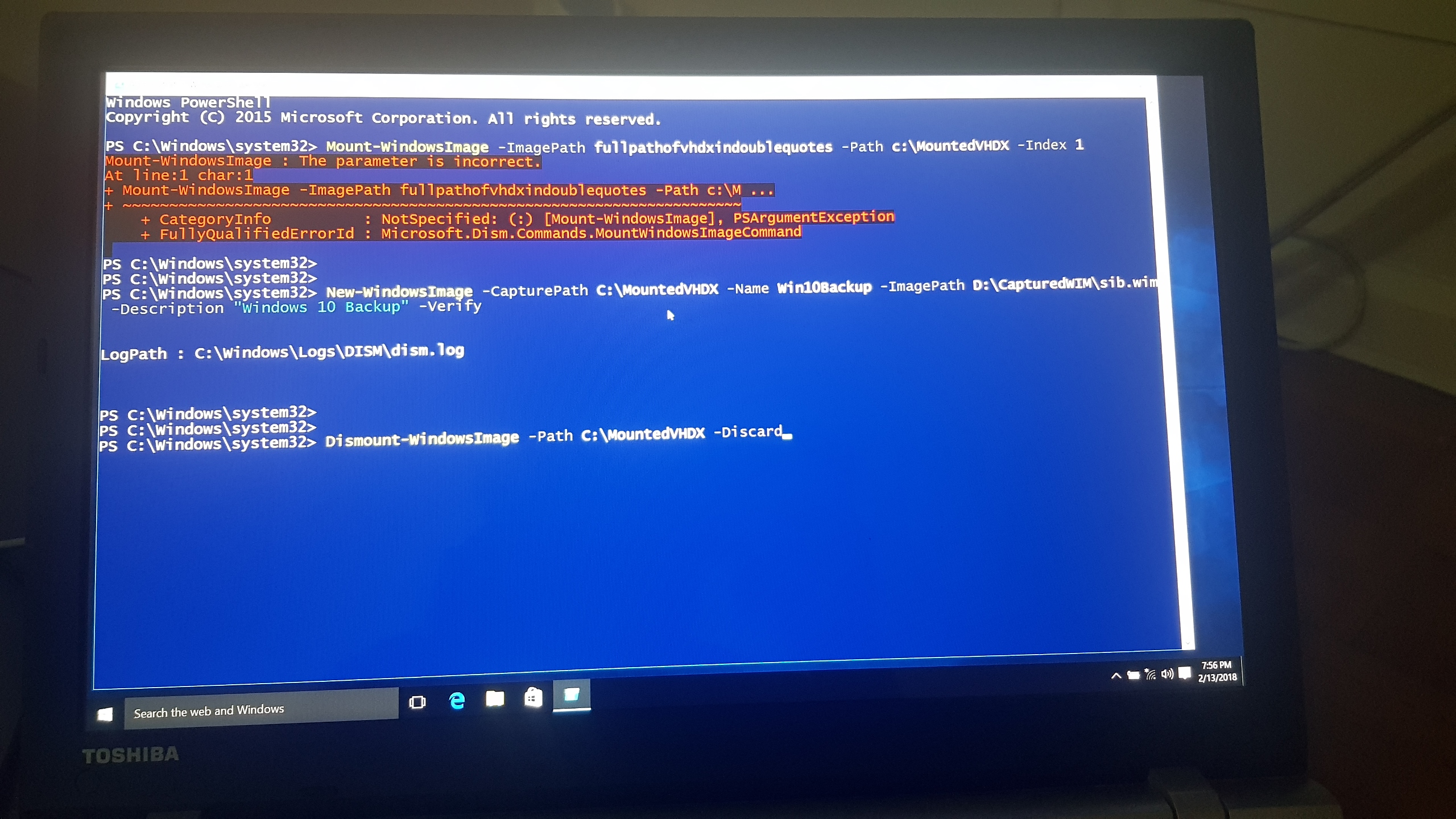

    2018-02-13T11:51:03+00:00
    Hi there, while launching the powershell and executing the command you have mentioned i get the red lines error as shown in the below pic, could you please tell me what wrong i am doing. And just a few question, the external hard drive we need to use does it need to be clean because i have about 400 gb of data on that hard drive and no where to save it and that hard drive comes as D: partation for me because E: is dvd drive on my laptop. And when it comes to 12th step:  do we need to enter the Format c: command first and press enter and then the rest or its all together and then press enter?
    Regards,
    Ryan
