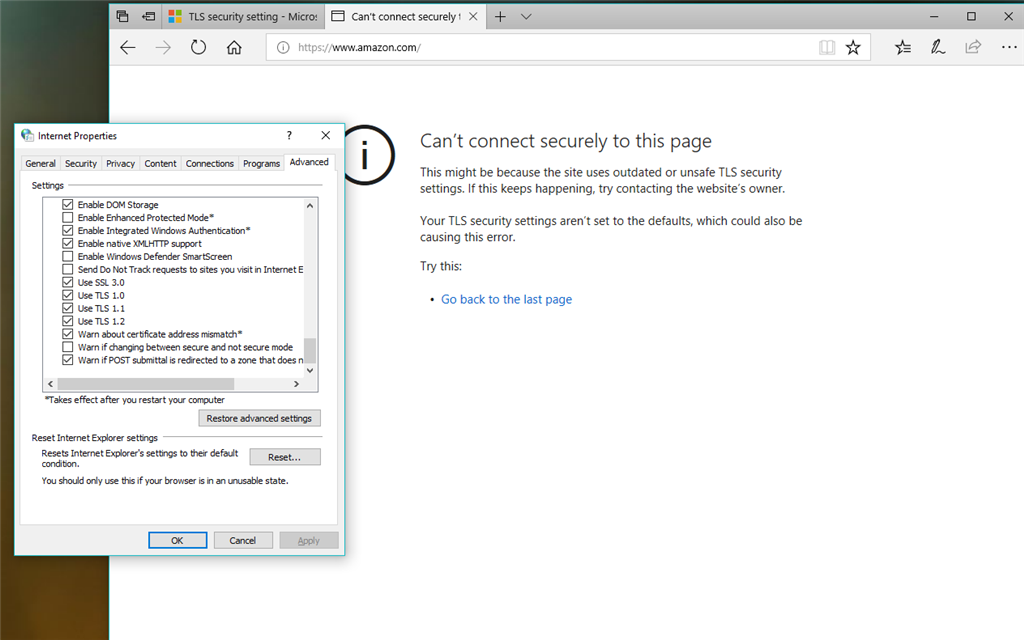

Can’t connect securely to this page
This might be because the site uses outdated or unsafe TLS security settings. If this keeps happening, try contacting the website’s owner.
Your TLS security settings aren’t set to the defaults, which could also be causing this error.
Good Day I am having issues,  I am getting that message when I try to register to an invitation I got from my employer

This error is often returned for other reasons than those given. However, to ensure that you have the recommended settings for TLS, follow these steps:
  1. Press Windows key + R to open a Run box. Type control and press Enter to open Control Panel.
  2. Select Internet Options and open the Advanced tab.
  3. Scroll down to the Security section and make these selections:
If the option to Use SSL 2.0 is present, it should not be selected. 4. Click Apply and OK. 5. Close Control Panel.
These settings will make it possible to connect securely to most reliable websites. If you continue to see the same error, try again later. If there are still problems, they are most probably at the website. Use a Contact us option at the site to draw attention to them.

    this did not work for me in either IE or Edge.  I did reboot.
    It works one time only if I clear my browser history; this is the only setting that works.
    This problem has been going on for many months.
