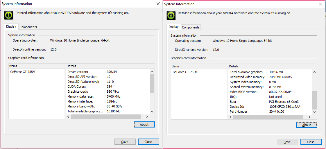

    Under "Set Physx Configuration" Physx processor was set to (Auto Select), there are "Geforce GT 755M" and "CPU", I selected "Geforce GT 755M".
    Under "Manage 3D Settings" Preferred Graphics Processor was set to (Auto Select), there are "High-performance NIVIDIA Processor" and "Integrated Graphics", I selected "High-performance NIVIDIA Processor"

    Nvidia physx is off and should be on.
    There are 3 gpu's, nvidia, intel and microsoft basic display driver,
    the game should be using the nvidia card.

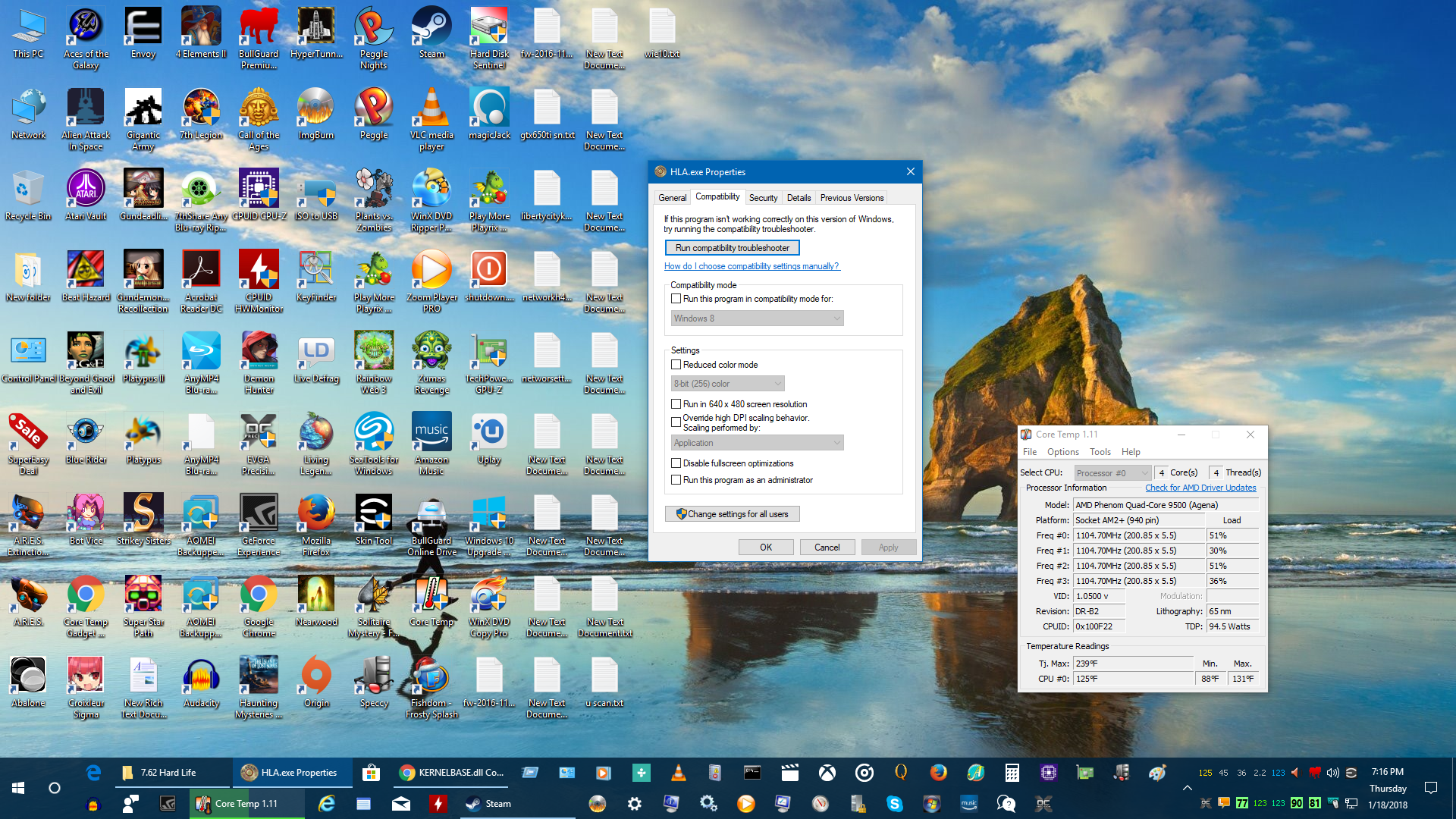

    I tried to run compatibility troubleshooter for both games, then selected to try compatibility settings, it recommended to try in windows 8 compatibility mode for both, I tested that but it didn't work, still had the same problems for both of them that I was having before. I already tried verifying the integrity before and that didn't fix it.

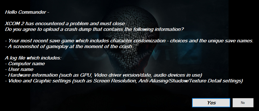

    I copied the log file for the crash at the bottom if you can make any sense out of it. It says in the log file that it is unable to find the game exe in the steam folder, and I actually did not find it either when I opened the folder. I'm going to try to delete all mods, the saves, and delete and reinstall the game, though I already tried that before and the game is 70GBs so takes a long time to download. :(

    What is your native screen size, how many monitors displays are connected, how many gpu's cards chips and on cpu and is dsr active on any.
    Have you checked the exe parameters if compatibility mode is on, disable high dpi scaling is active.
    In steam select properties, local files, browse local files, on the exe, right click,select  properties, compatibility; check each one, post your findings.
