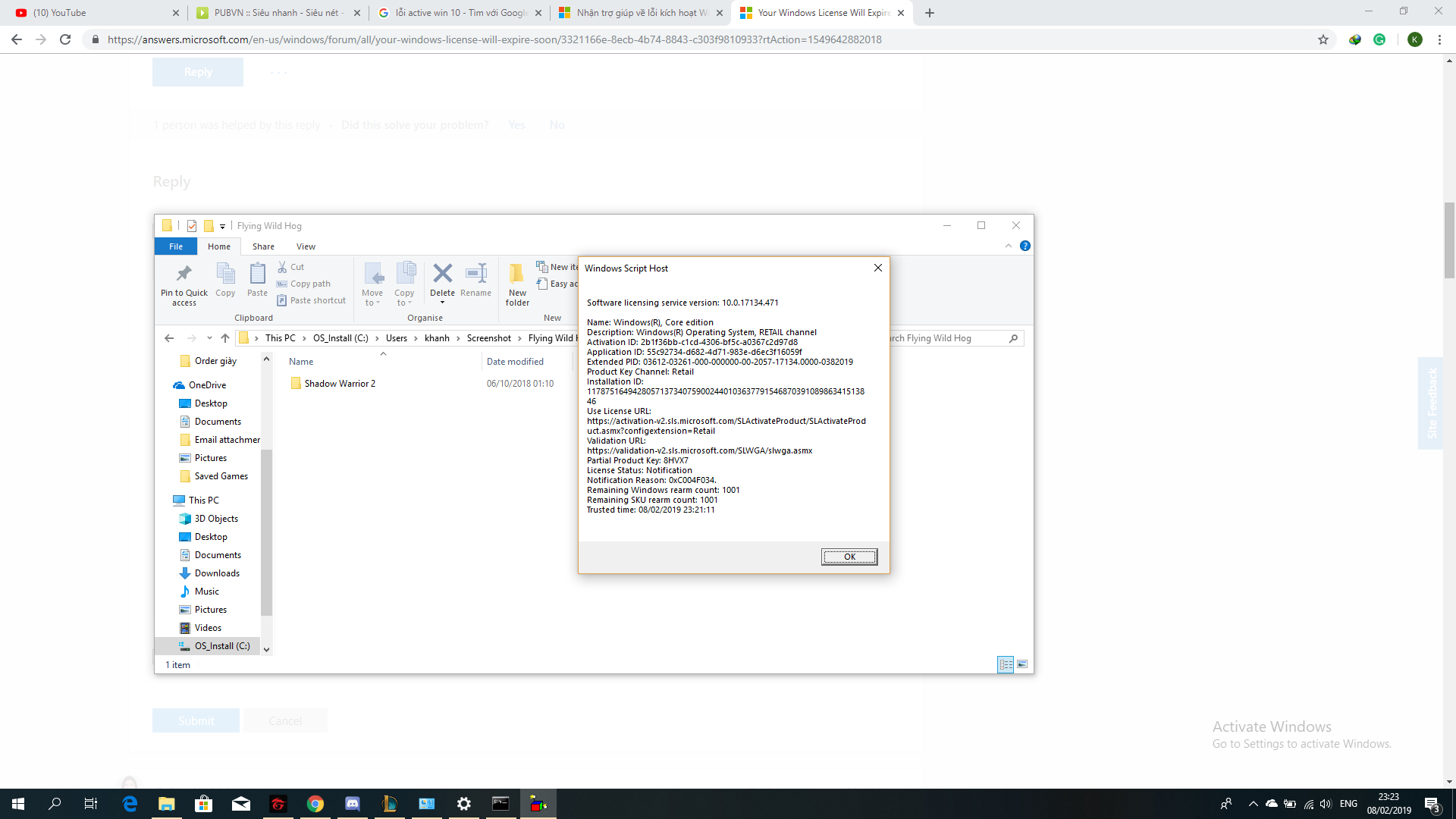

I'm currently using 'Windows 10 Pro' and my windows has been activated by my organisation's activation service. But i kept getting notification that my windows license will expire soon, it started happening after windows update.
I've tried using slmgr /upk and logging out of my microsoft account but none of that seems to work, I suspect that this is caused by the windows update because before the update I never get this notification.

First, check the type of license installed on your system.
  1. Open administrative Command Prompt.
  2. Type slmgr /dlv and press Enter key.
  3. Note the Product Key Channel section Windows Script Host box:
If it mentions OEM <method>, you’ve OEM license installed.
If it says Retail, you’ve retail license installed.
If it mentions GVLK, VOLUME_<method> then you’ve volume license installed. Note that GVLK stands for Generic Volume License Key.
Retail license users facing this issue, run Activation troubleshooter:
https://support.microsoft.com/en-in/help/20527/windows-10-activation-troubleshooter
Contact Microsoft Support or license vendor, if issue still persists.
In case if it reports that you've volume license installed, then it is not a valid license to be used by end users (correct me, if your system is part of organization).
In this case, you need to buy genuine license for your Windows 10.
