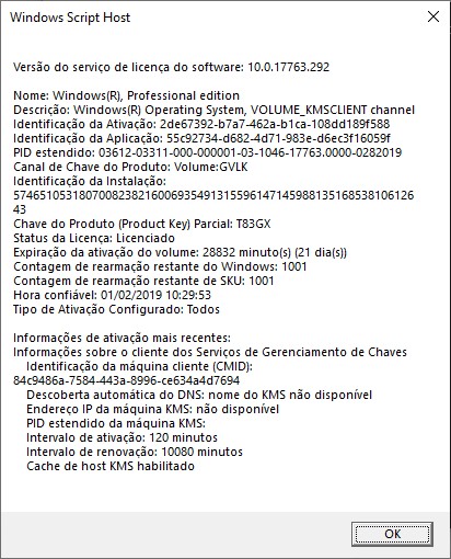

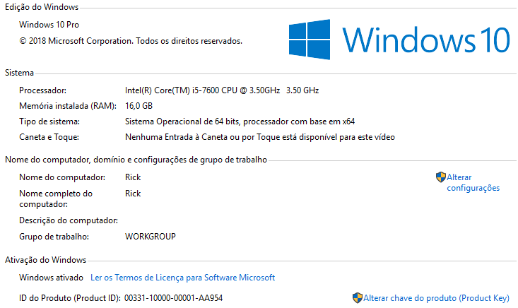

    2019-02-01T13:00:07+00:00
    Hi.
    I´m facing the same issue, this license is not from any organization, it´s an upgrade from Windows 8.1 and now I don´t know what to do, please someone has any suggestion to fix it or only by buying a new license?

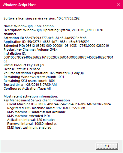

    2019-01-28T11:45:59+00:00
    You might have a volume license client installed. To confirm:
    Open Start, type: CMD
    Right click CMD
    Click Run as administrator
    At the prompt, type: slmgr.vbs /dlv
    Hit Enter
    Take a screenshot of the resulting dialog then post in a reply here.
    Learn how:
    https://answers.microsoft.com/en-us/windows/wik...
