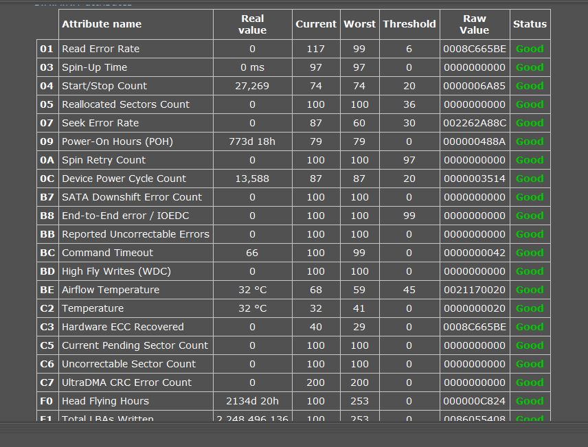

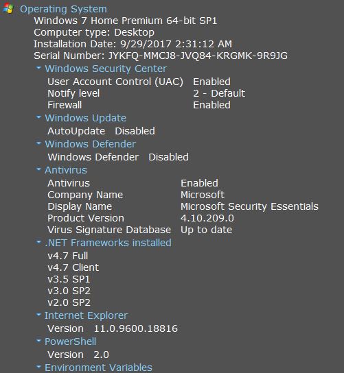

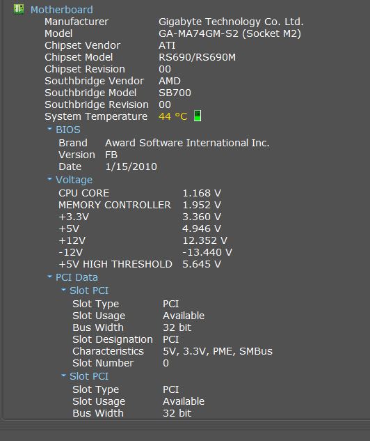

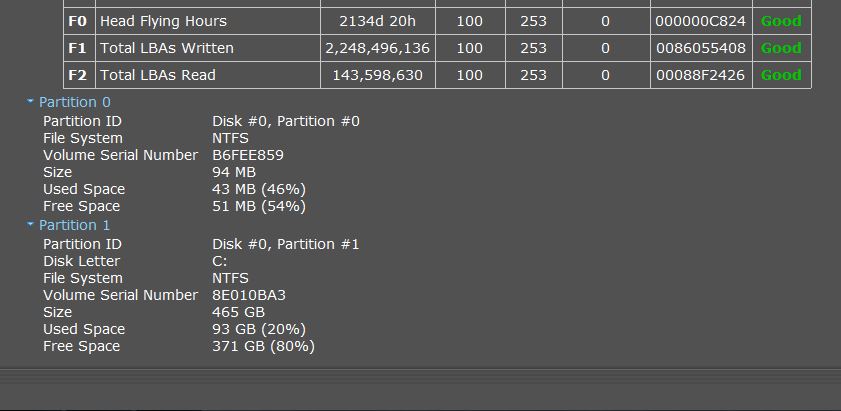

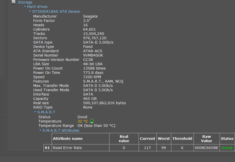

    When you get a chance Please review the following snips.  I really do appreciate you!
    Hard drive A
    Hard drive B
    Hard drive C
    Motherboard
    Operating System
    Many Thanks!      CarrmasDad2

    Since my last post I have downloaded Speccy and have it in a zipped folder, how can I send it to you?    A few year ago I used OneDrive to send Info but I have not done it since and to be honest I flat forget how to do it!
    Thanks   CarrmasDad2

    If you were my client and brought me your computer with all that you have told me, here is what I would do.  I would do this for you, but the circumstances are that I cannot.  So, I will outline the procedure I would follow.
    I should tell you at this point that it is my policy and for all my clients, that I do not allow Microsoft to update Windows any further after this installation.  There are specific security updates that I do apply and after you have completed the process described below, I will offer you a specific list with links of those updates.  But, please understand from the start that if you wish to follow my advice, it comes with the understanding that you will be setting Windows Update to the Never setting and leaving it there permanently.
    Also, you asked my opinion on antivirus protection.  Specifically, I favour Bitdefender Antivirus Plus.  Please note well the exact title.  I do not recommend any "Security suite".  Only pure antivirus software.
    Also you asked about my recommendation for a mail program.  I recommend you use WLM 2012.  When you get to the point that you are ready to install that program, I will offer you specific step by step for that.
    My greatest concern at this point is that you follow the instructions I now offer precisely as described.
    If you have any concerns or question before you begin or during the process, please do not hesitate to ask.
    I would first buy a replacement hard drive.  I would buy a 7200 rpm either 500 Gig or 1000 Gig (1Tb) replacement.  Either WD or Seagate.  I would likely buy a WD black which comes with a 5 yr warranty and is designed for long running.
    1. The hard drive has failed.  You will have to replace it.  Replace with a 500 G or more rotating 7200rpm drive.  500G drives can be found for around $70.  Typically quite easy to replace.  Now you will need a complete Windows 7 install.
    2. I do this all the time.  I have done hundreds.  This is likely to take an elapsed time of around 12 hours.
    3. First go to your computer’s OEM support site and find and download the drivers for your computer and store them on a USB stick.
    4. From this point onward, I am providing you with the process to install Windows 7.
    5. You maybe able to take your data off first.  Remove the failing hard drive and put it into a USB external drive housing.  Connect to a working PC, copy the data off.  You may need a friend to do this part for you, but the rest is not really very technical or difficult for most people.

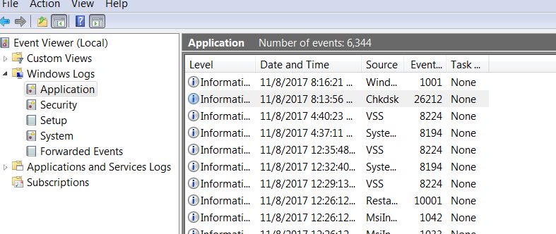

    1. Click on Event viewer
    2. Click on Applications
    3. WAIT for the list to fill out, it can take some time
    4. It is a long list.  In the list you will find an event called wininit.  It will be posted at the time chkdsk completed.
    5. Double-click the Wininit event and it will display in a window.  You will have to use the scroll bar to see the entire report.
    Hi  Canadian Tech Re: Your November 10 2017 post
    After scrolling through the Applications I found the following info.  I scrolled thru all of the events for the date of 11/8/2017 and Wininitis not there, do I need to run Chkdsk again?

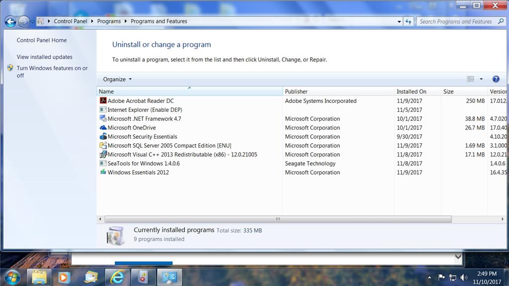

    The following is my list of 9 programs
    please tell me what is going on!
    At the bottom left corner when I open All Programs there is at least 20 listed!
    Many Thanks       CarrmasDad2
