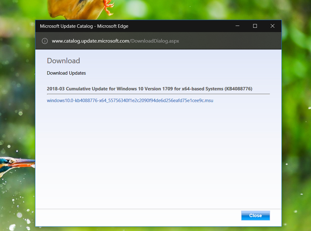

    Certainly. Click this link: Microsoft Update Catalog
    Select Download to the right of first file offered.
     Click the blue highlighted text as shown here.

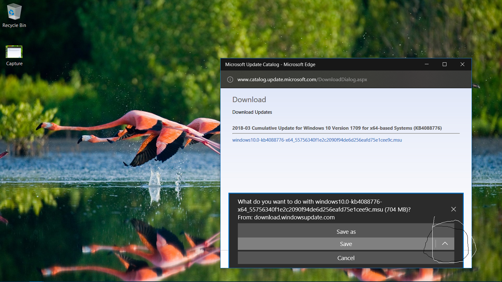

    Right click the arrow next to the "Save" option and choose "Save as" as shown here:
    And save it to your Desktop.  Then double click the Strand Alone Installer to run it once it has fully downloaded.
