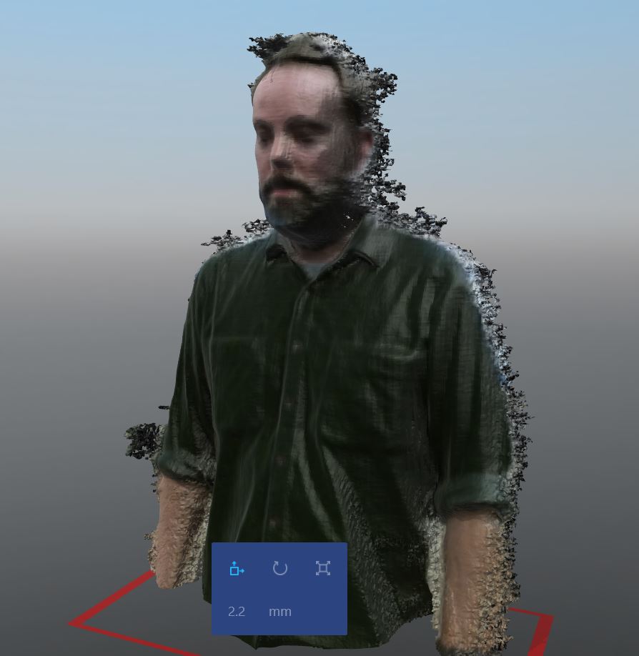

    2017-08-14T08:18:33+00:00
    Dear CBGrant [MSFT]
    Many thanks for your reply.
    As you suggested, I tried to slightly change the depth settings and it's working a bit better with the Kinect fixed and the subject rotating.
    However, with the previous version of 3D Scan, it was possible to have the kinect on a tripod and to scan the subject still in front of it, scanning only the front with no elements moving.
    With the new revision, this seems to be impossible, as the error message appears, saying that there is not enough data to reconstruct the model.
    Please see attached image of a scan with the previous version, both the Kinect and the subject are still.
    Isn't this method available anymore ?
    thank you!
    Marco
    2017-08-11T18:02:44+00:00
    Marco,
    With your scans is the Kinect stationary or rotating around the object?
    Matias' problem was an incorrect depth setting and I think your problem might be the same.
    Remember to use your hand to find where the depth ends. Move your hand slowly away from the Kinect until it turns grey. If the Kinect is stationary and the object is rotating make sure, and this is important, that the Kinect does not see anything that is not rotating. If it catches a glimpse of a stationary wall or chair, the scan will be incomplete or partial like you are seeing. If the Kinect is rotating around the model then make sure you set the depth to be able to see everything you want scanned and walk around the model.
    Unfortunately, you cannot adjust the resolution settings in the current version and there is no way to re-install the old version.
    Let me know if any of this helps. If it doesn't please attach pictures like Matias did so I can get a better idea of what is happening.
    Thanks!
