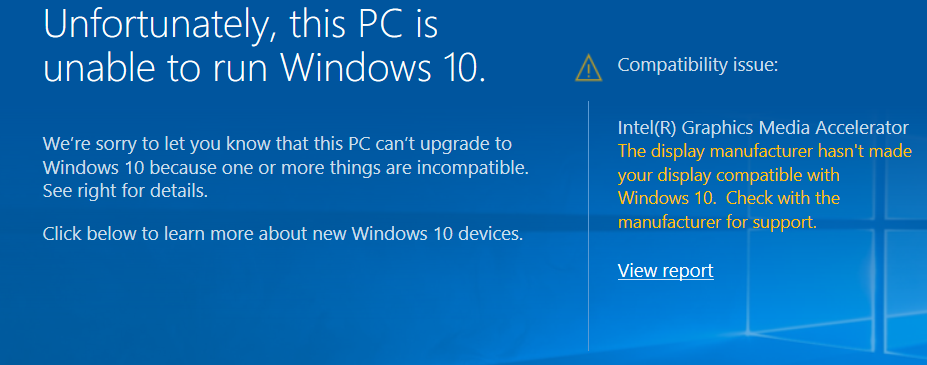

    I'm going to start banging my head against the wall...
    I went to update to 10 via the GetWindows10 app and it says it can't because the graphics accelerator is not compatible.  Here I thought the sound driver was the only problem...
    Any ideas anyone?
