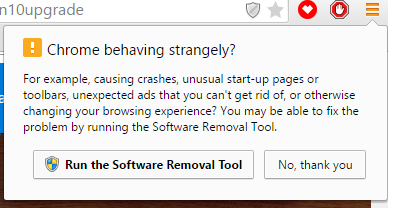

    2015-06-06T16:22:30+00:00
    Are you referring to Chrome's Software Removal Tool?
    Yes I do mean that.
    What you mean it came as an update for Chrome? Included (integrated to) Chrome? Or perhaps you meant it popped up for you to run it 'before' updating Chrome?
    This is what I meant, wasn't sure how to explain it.
