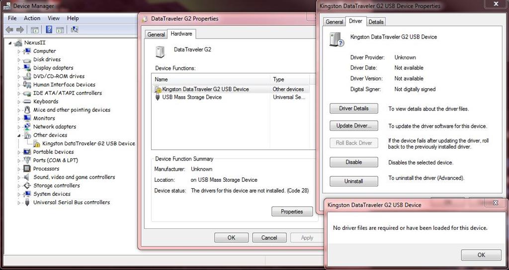

    If I rightclick the device and select "uninstall" and then select "scan for hardware changes" then it's back in "Other Devices" and I get an error that no drivers is found:

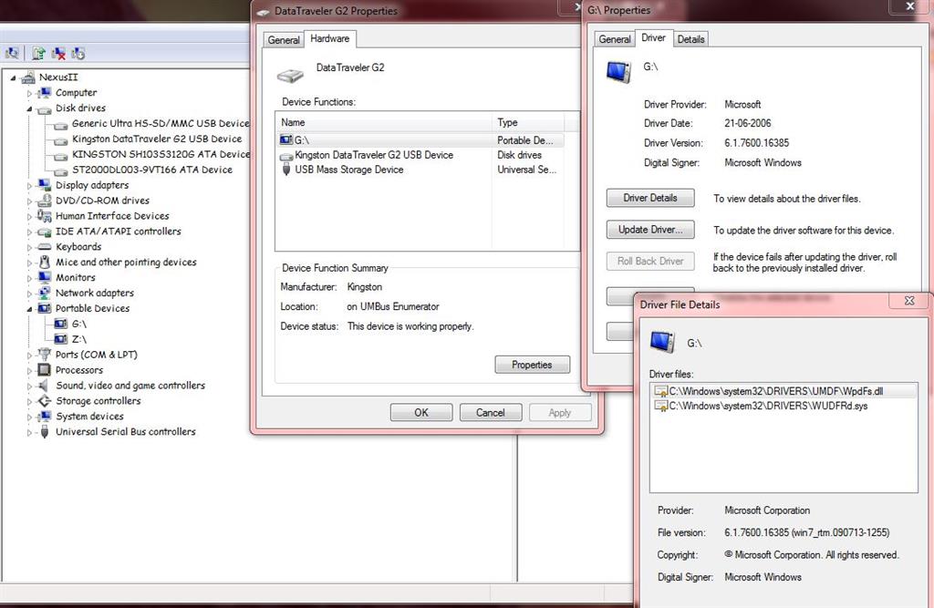

    No, only when it's plugged in. I can force install drivers for it by pointing to the repository.
    It just looks like it can't find the drivers in the standard paths for some reason.
    When force-installing by pointing to "C:\WINDOWS\SYSTEM32\DRIVERSTORE\FILEREPOSITORY" then I get this:

    Does it show in Other Devices if the the Kingston Data Traveler is not in the USB port?
    2014-09-25T00:50:22+00:00
    I can not see what's on the Kingston Data Traveller UNLESS I force Windows to get the drivers from "C:\WINDOWS\SYSTEM32\DRIVERSTORE\FILEREPOSITORY".
    It's not even in Portable Devices at the moment. It's under other devices.If I go to Driver and select Driver Details, then I get a popup saying
    "No driver files are required or have been loaded for this device."
    Yes, I always use safe removal on my usb devices.
    See screenshot:
