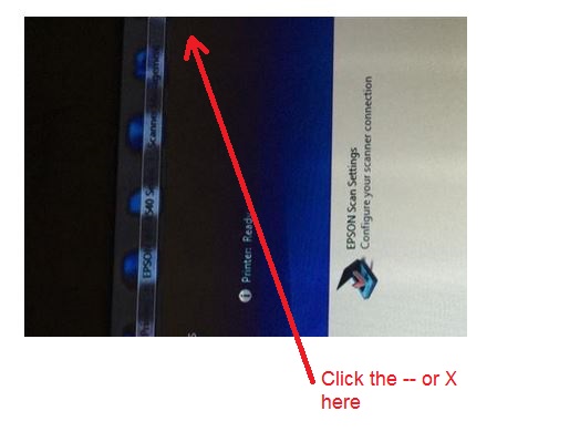

    What I meant was to minimize or close the main window by clicking on the dash or X in the upper right corner:
    But I won't be surprised if you do that and don't find anything hidden behind the window.
    What happened when you right-clicked the icon for your scanner in the main Devices and Printers window (not the screen in your screenshot)?
    What happens if you double-click on the left icon shown in your screenshot (the one that just says "EPSON Scan")?

    2015-04-19T21:07:30+00:00
    The first issue I did click on scanner settings but what you are seeing is my pointer ONLY POINTING.
    there is no choice to minimize or maximize . If I right click on the list there is open clicking on that does nothing it stays down there . I can't get a window to open to view it at all. By pointing is the only way I can see there is something there .  There is only one box not two that comes up and when I say comes up i mean stays AERO PEEK VIEW.
    I have installed and re- installed and still the same darn it

  5. LemP 74,985 Reputation points Volunteer Moderator
    2015-04-19T20:15:23+00:00
    Your screenshot shows what you get when you double-click on the icon for the device in the "Devices and Printers" window.  It looks like you then double-clicked on the "Epson scan settings" icon.  The small image at the bottom is the "aero peek" view, which is supposed to show a window hidden behind the main, full-screen window.  It should come to the foreground when you click on it; if it doesn't try minimizing the (or even closing) the window that shows the two icons.
    Have you installed the Epson software that came with your 4540?  That will make configuring it a lot easier.
    Otherwise, instead of double-clicking the icon for your scanner in the Devices and Printers window, right-click it.  I don't have this product installed, but you should see a context menu with items such as "Properties" or "Scanner properties."  Select this and perhaps the configuration you're looking for will be available.
