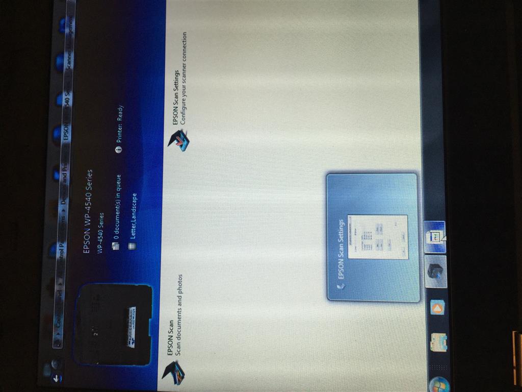

    I have included a picture of my screen showing you how I cannot fully open the scan settings . I click on it and it stays at the bottom . When I point to it as u see in my pic , I can see there is stuff written but unless I can maximize it I can't read it. There is no option to maximize when right clicking either . And double clicking isn't enlarging it .
    Could this be a certain setting as well??
