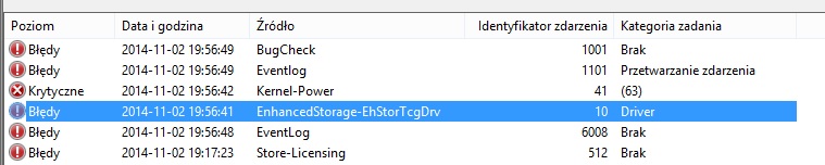

    2014-11-02T19:11:28+00:00
    It appears I have the same problem as described above. I just run chkdsk /f /r yesterday but right 5 minutes ago BSoD appeared again, so it did not resolve the problem. Any other ideas how to stop it from appearing? Mine SSD is Crucial M500 240 GB.
