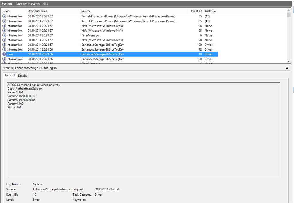

    2014-10-08T18:26:35+00:00
    same error with different user:
