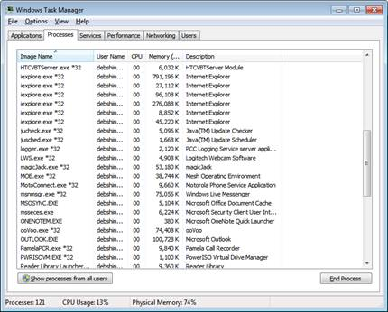

So how do you go about examining the processes in the first place? Many IT pros would start with the obvious: Task Manager’s Processes tab. Task Manager has been improved in Vista and Windows 7, in comparison to Windows XP. The Description column, which gives you information about what application is using each process, is a welcome feature that’s shown in Figure 1.
Figure 1

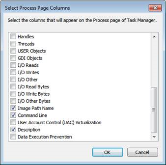

You can get additional information in Task Manager by going to the View menu and clicking Select Columns, then checking the boxes you want, as shown in Figure 2.
Figure 2

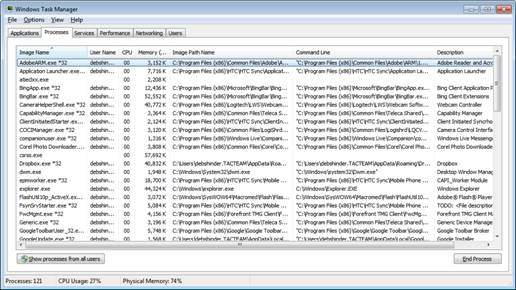

For example, you can display the image path name to show the full path to the file that’s connected to the process. Or you can check the Command Line box to show the command, with any parameters or switches that was used to launch the process (malware often has strange looking command lines). You can see this additional information in Figure 3.
Figure 3

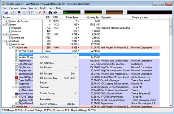

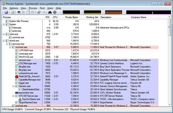

Using Process Explorer to Identify Malware
Process Explorer is a free 1.47 MB download from the Windows Sysinternals web page on the TechNet site. It runs on Windows XP and above. Current version is 14.1 and you can get it here. You can also run it from this link
As you can see in Figure 4, it gives you a different view of your processes than what you get with Task Manager.
Figure 4
You’ll notice that in Process Explorer, the process tree in the left column shows parent-child relationships. If one process looks suspicious, related processes may also be. An extremely handy feature is the ability to right click a process and select “Search online” to do a web search for information about the process, as shown in Figure 5.
Figure 5
One thing to keep in mind, though, is that some malware will use pseudo random generated process names, in order to prevent you from finding any information in a search.
