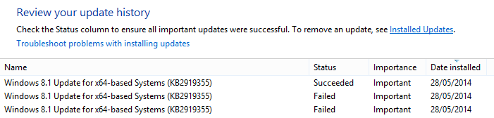

    Ran update - it worked, I think. I now appear to have KB2919355 installed:
    However, DISM /online /get-packages says KB2919355 is ‘staged’ (whatever that means):

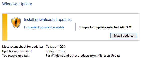

    And if I check for updates I get:
    Which looks horribly like KB2919355 again! So I'm  not going to risk it.
