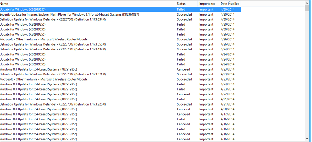

    2014-04-30T05:56:15+00:00
    after trying all the suggestions it still ended up with error code 80073712
    error just wont go away
    here is a shot of my updates
    it has been failing stand alone or trough windows update

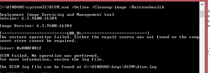

    here is the error on the second dism command
    2014-04-30T04:57:33+00:00
    As per the screen shot you have sent, error code 0x80073712 issue is been fixed.
    Run the System File Checker tool , restart the computer, try installing the Windows update  and check.
    Use the System File Checker tool to repair missing or corrupted system files.
