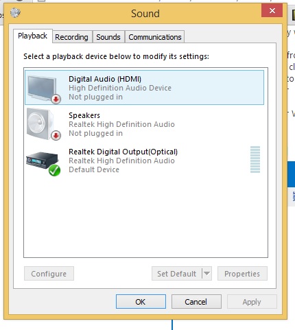

    My HDMI TV Monitor is picked up - but it says it is disabled. I get Video through the HDMI cable, but no sound. The sound worked in windows 7 but now with windows 8.1, only the video shows up.
    Any help is greatly appreciated.
    Go into Device Manager
    Expand Sound, Video, and Game controllers
    Right click on High Definition Audio Device
    Select DISABLE
    Right click on High Definition Audio Device again
    Select Enable
    It should now be working. If not:
    Go back to your Sound Properties
    Under the playback tab, you should see your HDMI Device
    Right click on it and select Set as Default Device.
    Both your video AND sound should work now.
    I have to do this everytime I unplug my damn HDMI cable. I never had to do this until I upgraded from Windows 8 to Windows 8.1. It's ****.

    Im going to the sound/playback, and i have it completely updated, but instead, it has just : Not plugged in. I cant configure it to default, and im trying to use it to record videos, and i cant, since i cant record system sound. Please help, ive done all these steps and nothing is working
