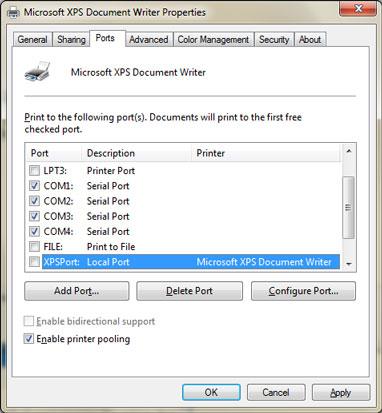

    2013-12-22T21:11:59+00:00
    Yes it would if e.g. :
    you print with a PS driver and the other device understands PS as well of cause ignoring the options that are not present on the substitute device. (e.g. printing black & white if the first one was a colour device, printing two sheets one sided instead of one in duplex, etc.)
    The same applies to PCL (5) and PCL XL (PCL6).
    It's not going to work for GDI print drivers unless they are identical...but who is using GDI for network printing?
    Btw...there's an old feature called printer pooling which connects identical print devices to the same printer via several ports, so if one isn't available it queues it automatically to the next ready device.
    Just as an example....
