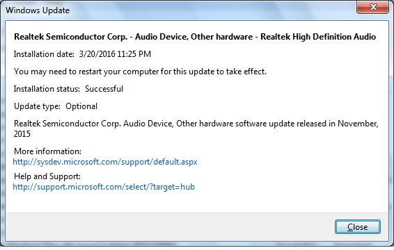

    In case anyone else has this same issue I figured I show the Realtek update that fixed the problem on my Windows 7 computer.
    I really don't have any further info on this update other than that the update found me, not the other way around and it was about 95mb. Hopefully the websites shown on the screen capture can help you further.
