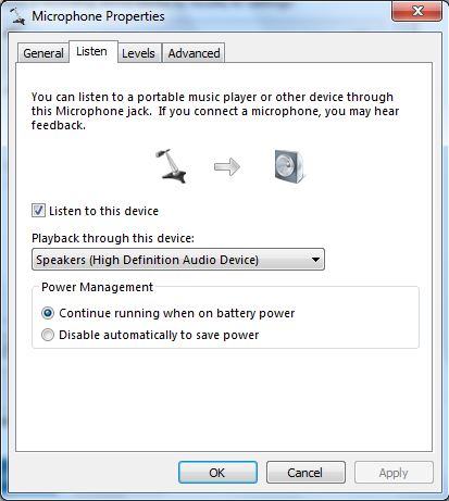

  3. **Now this step is going to take a little bit of thought for each computer being used: on my laptop (HP Elitebook) I get a device "Stereo Mix", ENABLE this device.
  4. Click on Properties, go to the tab 'Listen'
  5. Check the box "Listen to this device", also change the drop-down box below "Playback through this device" to be your second audio device

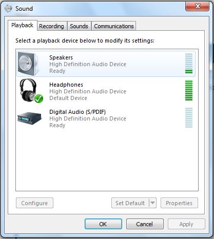

-- To verify that you've done this correctly, go back to the Sound dialog tab Playback, you should now see both of your audio devices showing the little green graphs moving.

    On your Sound Window > Playback > Speakers are the default speaker ie. normal speakers ( mono, stereo or surround system)
    Headphone > same as the icon refers headphone or earphone -  if you are frequent headphone listner use that as default
    Digital Audio is with HDMI or optical
    on Microphone Properties
    Listen to this device means the sound through the microphone will be output through those device

    Thanks bro, it solved my problem. Still can't figure out that which device to set default and which to listen? Below are the both settings, are they good or not? Any Suggestions?
