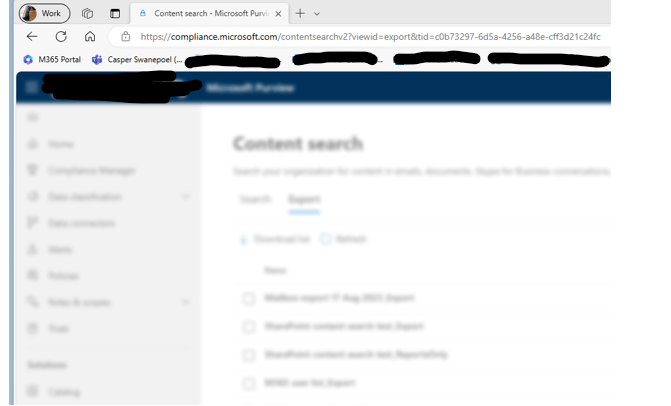

Sometimes when I am using MS Edge, the window display blurs seemingly without cause and stays there for a few minutes. When I say "window display" I mean it only applies to the Edge Work window I have open (I don't remember it occurring with other profile windows), and it isn't the whole window, but only the page display which is everything below the URL line.
At first, I suspected this might have something to do with Sleeping Tabs since it sometimes occurs when I step away from my computer. When I return, if I click anywhere on the page display, it returns to normal. However, I tried disabling sleeping tabs when it occurred randomly (while I was using the page) and it still persisted.
Apart from when I have left the computer for a while and clicking, there is nothing that I have found that consistently restores the normal unblurred screen. I have had some level of success with opening new tabs (this sometimes fixes it), but this does not always work and is not predictable.
Below are two screenshots - normal and blurred:
My current version of Edge is 118.0.2060.1 (Official build) dev (64-bit). I have also reported this through Send Feedback.

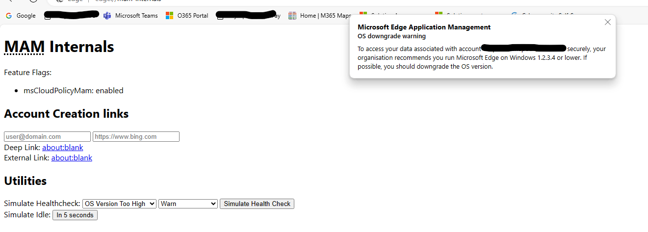

    The "1.2.3.4" warning is just a placeholder (it's only simulating stuff -- normally it'd come from whatever your admin has configured MAM to block).
    The change to deactivate the blur for MAM enrolled profiles without policies is in Edge Canary (or will be soon); it will take a week or two to get to Beta/Stable.
    To be clear: You're only seeing these blurs after 30 minutes of inactivity (where you're not interacting with that profile), right? And they should never impact your personal profile (the one where MAM isn't enabled). For example if you hit the "Simulate Idle" button on edge://mam-internals (in your personal profile), it shouldn't do anything -- whereas it'll blur in your Work/MAM-enabled profile.

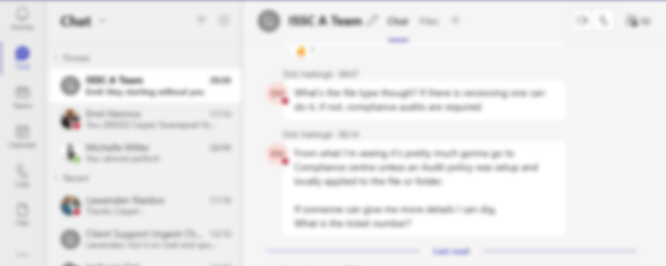

    I now also experience this blur issue on the work profile where MAM is enabled, without policies:
    And also not able to do the Simulate Health Check on this different Business profile:

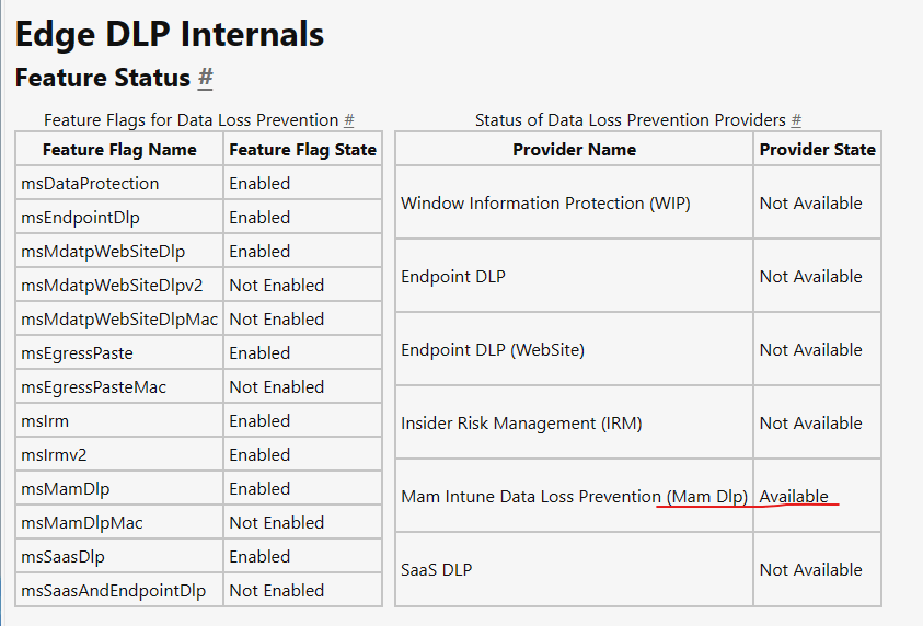

    Thanks! Unfortunately the edge://edge-dlp-internals results are not necessarily conclusive. If you have any MAM-enabled profile open it'll show "Mam Dlp" as "Available" (also applies if any such profile was open previously while Edge was running). So if you go to edge://edge-dlp-internals after exiting Edge ("..." -> Close Microsoft Edge) and re-launch Edge into your personal profile, it should show "Not Available".

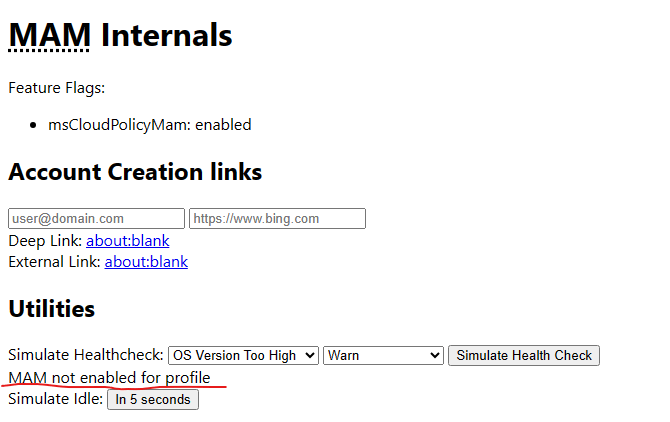

    It would be clearer to visit edge://mam-internals and see if the "Simulate Healthcheck" (OS Version Too High + Warn) reports "MAM Not enabled for profile". It looks like this is available in Stable now as well.

    Tx for the response. I see what you mean:
    Personal profile:
    edge://mam-internals/
    Business profile:
    When doing the OS Version too High test I get this weird result though:
    No chance I will downgrade my OS version.
    Edge version:
    Version 119.0.2151.12 (Official build) stable app, beta channel (64-bit)
    What does this mean in your comment?
    "It looks like this is available in Stable now as well."
    I never heard of Windows 1, 2, 3, or 4, or lower to be honest.
    Also advise on the downgrade prompt as that will not be an option.
    Unfortunately, the blur issue continues:
