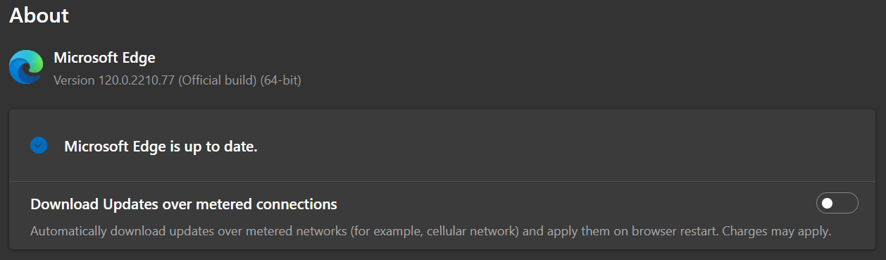

    For those who tried updating Edge through Windows Update, it does not work. What you have to do is the following:
    • Start Edge
    • Open the ellipsis menu in the upper right corner
    • Go to Help and feedback > About Microsoft Edge
    If an update is available, it will automatically start downloading it and you'll be prompted to restart Edge to apply the update.
    As of today, I updated Edge on all my machines through this procedure, and all of them downloaded an update that fixed the problem.
    That's it!

    Thanks N.K10 for the info.
    • Start Edge
    That's it!
    thank you!!!! worked for me!
